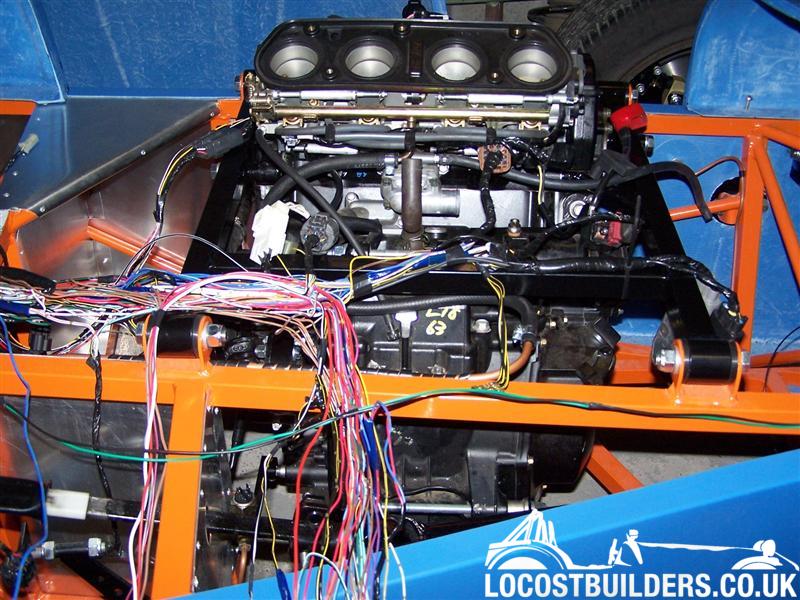

dan__wright
posted on 8/1/08 at 12:43 PM Reply With Quote
how did you attach the box to the tbs? i do have the original airbox so coul adapt that but i think something may be missing as there is nothing to keep it opn the tbs, there is a 2mm ish lip and thats about it

worX
posted on 8/1/08 at 02:08 PM Reply With Quote
do you still have the piece of black plastic in this picture on Rich's car?
I used this as I thought it was the best way for Paul's but at the same time it would be relatively simple to just make the base of the airbox fit the tbs easily...
Oh and do you still have the rubbers on the tbs???
[Edited on 8/1/08 by worX]

dan__wright
posted on 8/1/08 at 03:04 PM Reply With Quote
yeah i still have the part (bottom of the airbox that has the pipes on it?) and i have the rubbers and clamps on the tbs but cant get it to grip it.
will give you a call when im out it the garage after work (6ish?) if thats cool.
