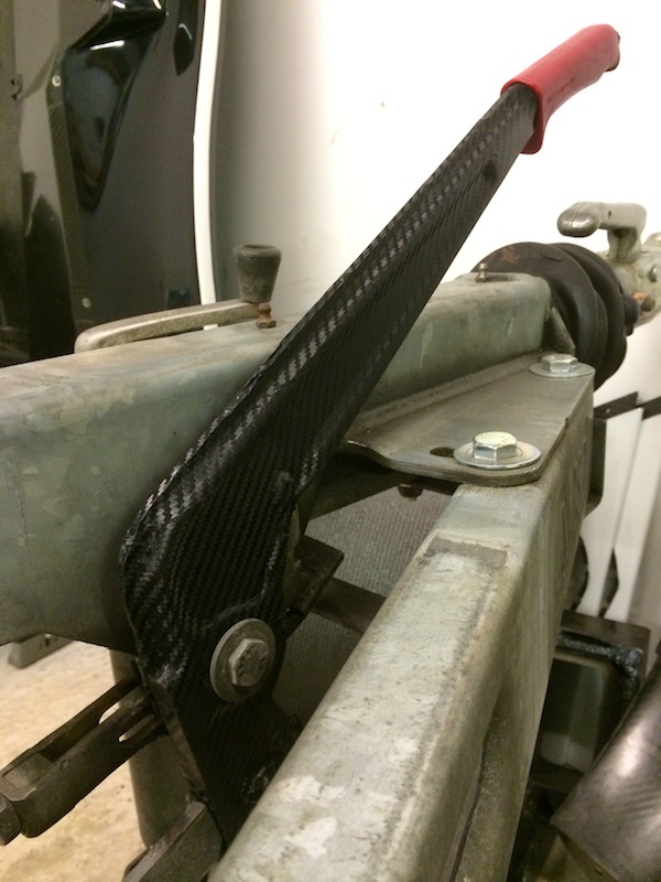

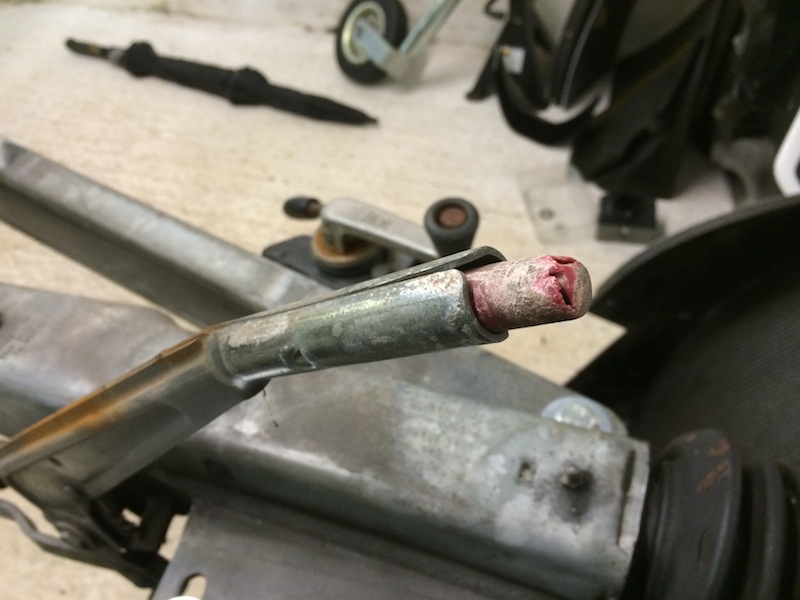

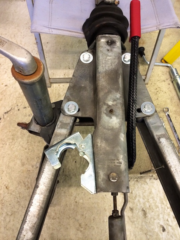

Didn't get up to much tonight, was feeling kinda crap, so I just did some tarty bits

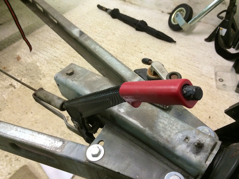

Trailer handbrake looked sorry for itself
So I treated it to a new Alko grip, and some wrappage lol

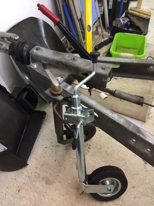

New taller jockey wheel ready to go on after I've shortened the A-section

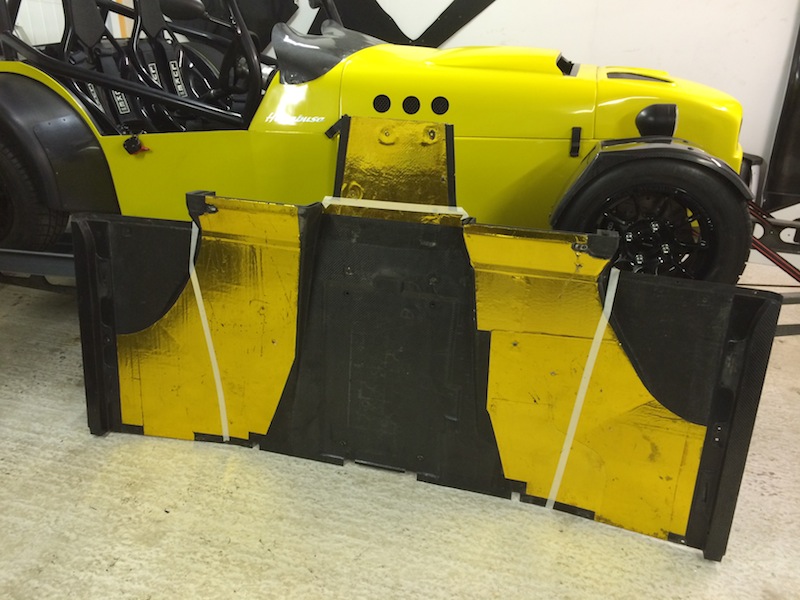

Then the next carbon cutting up culprit got marked up for its death, this shall be my rear diffuser, unless I cut it wrong and it all goes tits up lol

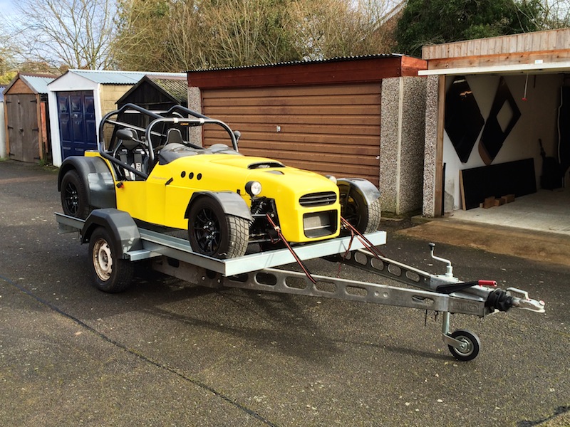

Bit of a long winded and tedious post - but worth it for those looking at making a trailer for themselves…

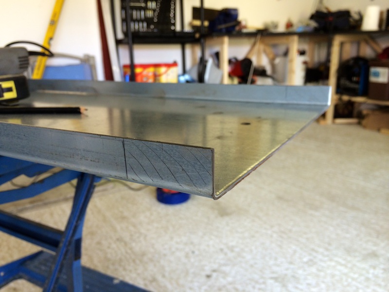

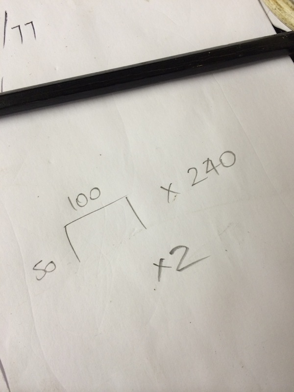

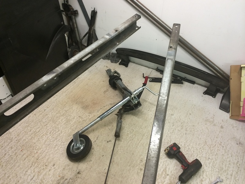

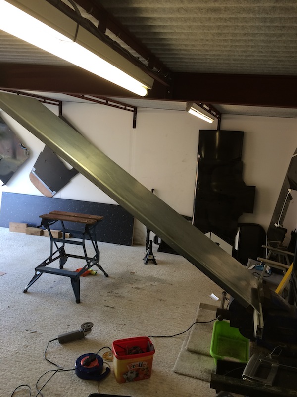

When I had the sections cut & bent by the sheet metal factory, I didn't let on what it was for, just the dimensions, so they just supplied me with bent ramps, no cuts… so that was todays task… to make them

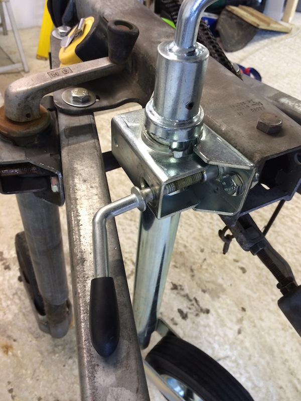

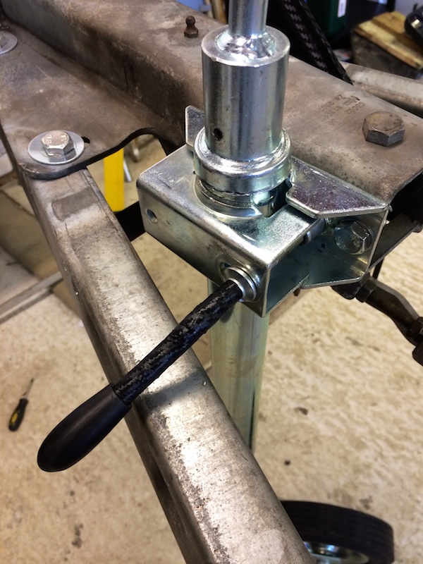

New longer jockey wheel will now be positioned onto the hitch itself as it already had bolt holes the correct spacing
With a problem that I knew was going to happen, couldn't be tightened

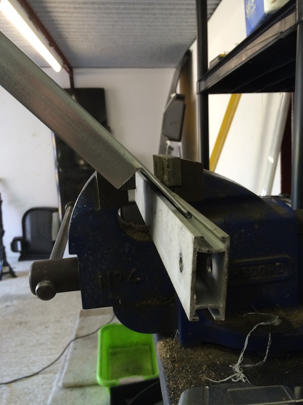

Whipped if off, stuck it in the vice, and wrapped it as it snarled up the metal a little, job jobbed

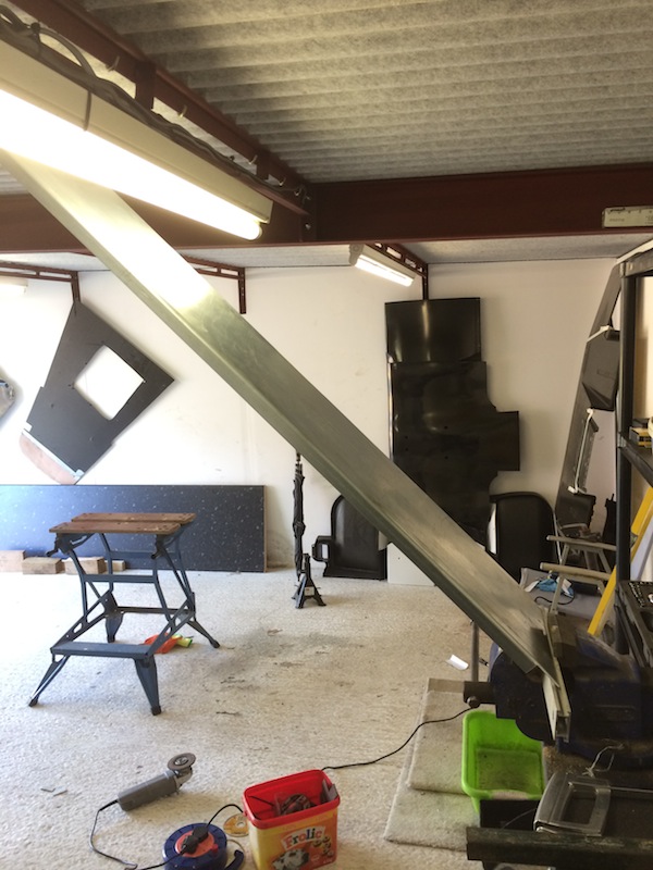

Something rather bright in the sky today, think it was the sun, which gave me the opportunity to make the ramps on level ground, I couldn't do this inside the garage, it's sat on a 4inch base, so the angles would have been wrong with them hanging out the garage door

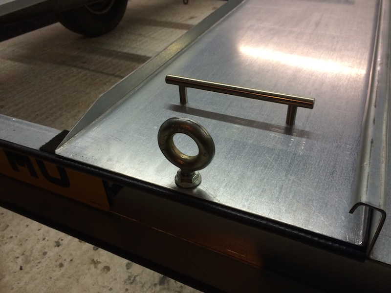

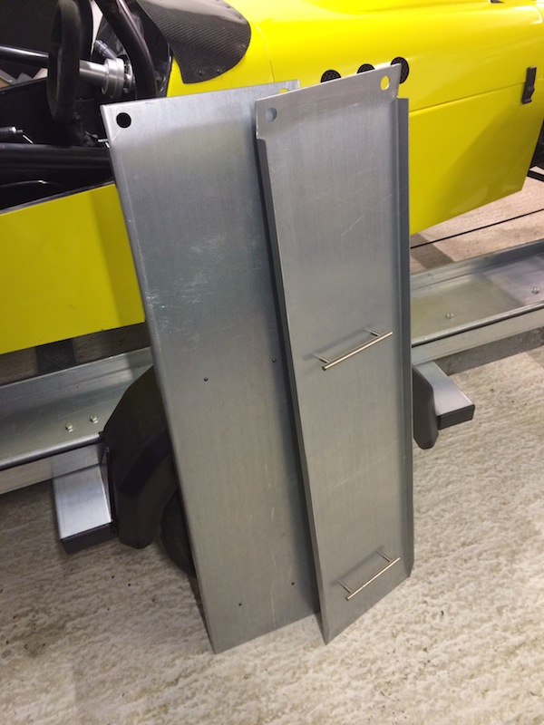

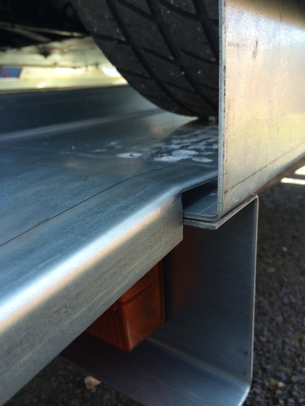

So with the jockey wheel up all the way, we have a very slight angle, however we are shortening the A-section, which will bring the jockey wheel 2ft further towards the trailer wheels, which may or may not eliminate this slight angle change

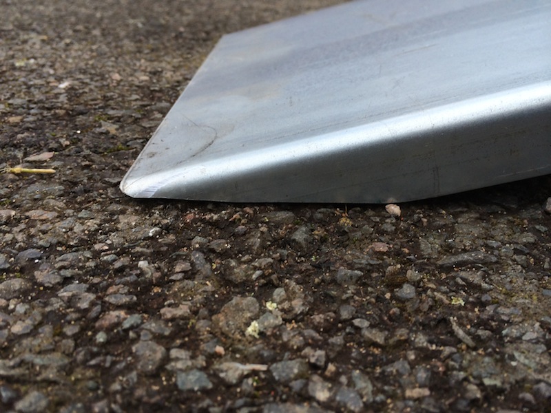

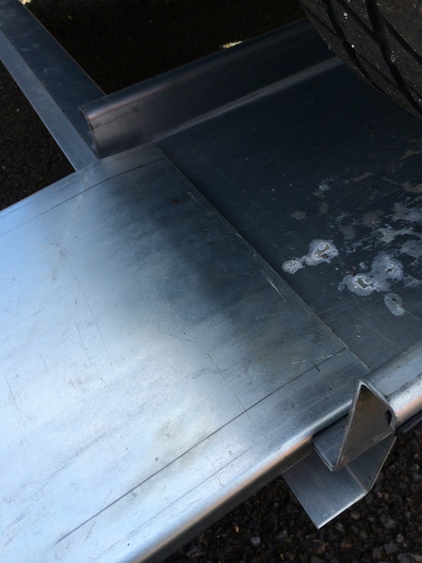

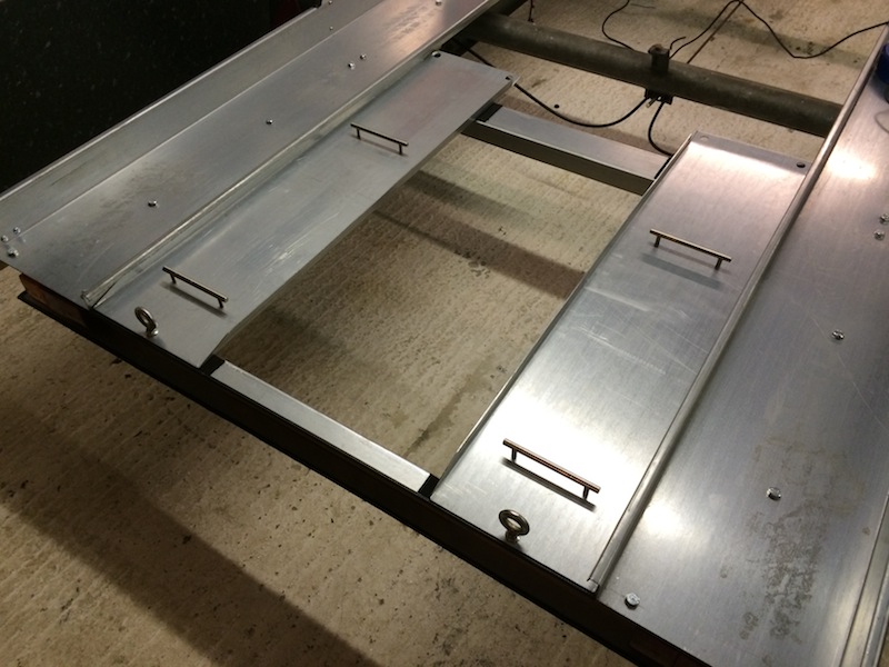

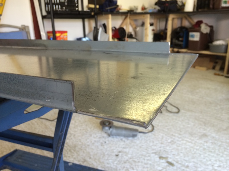

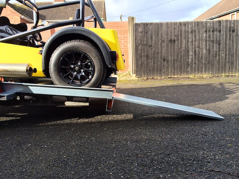

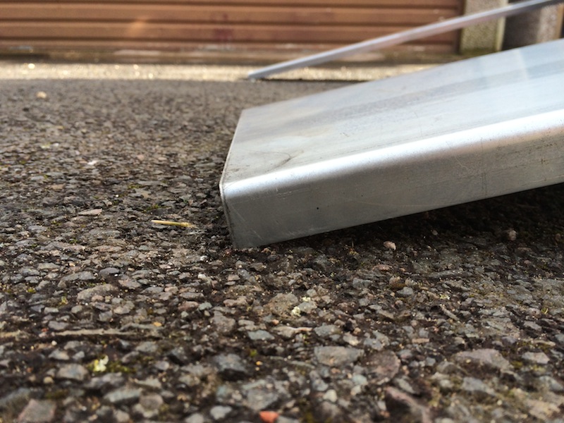

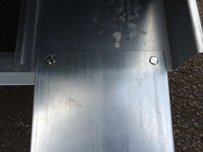

You can see here the ramps are just crude bits of metal, with folded 25mm edges, nothing else done them… so this is how I went about it

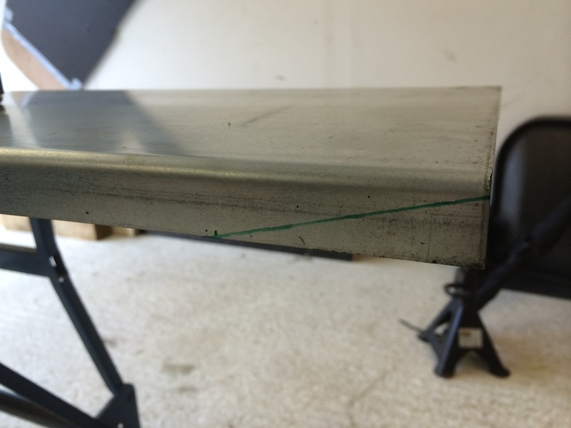

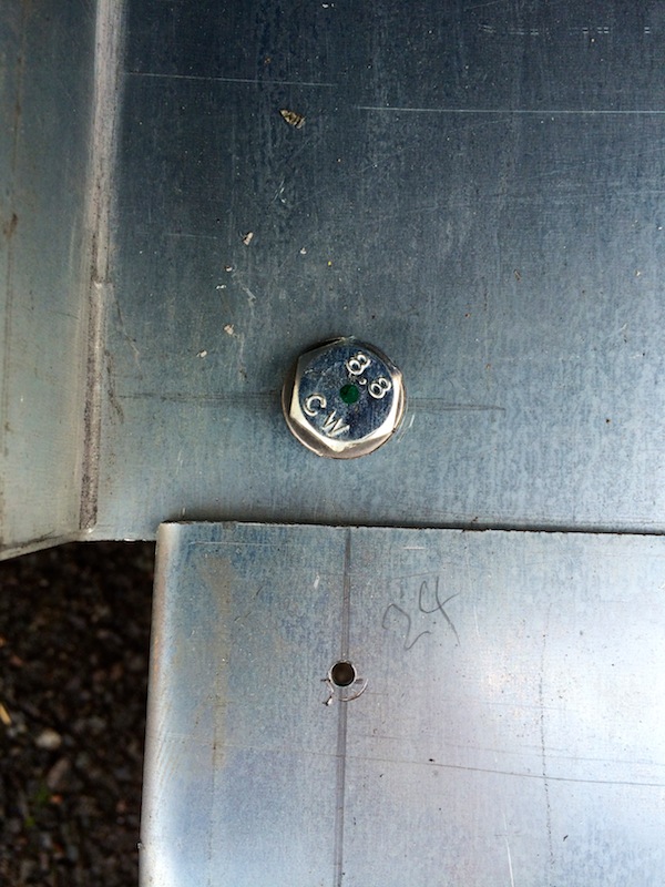

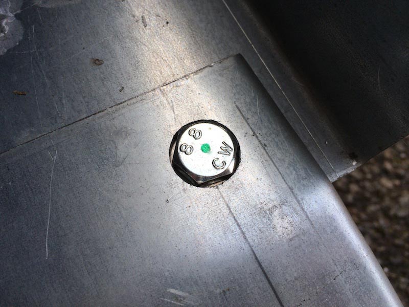

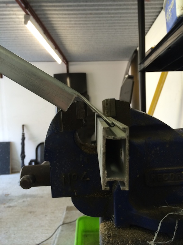

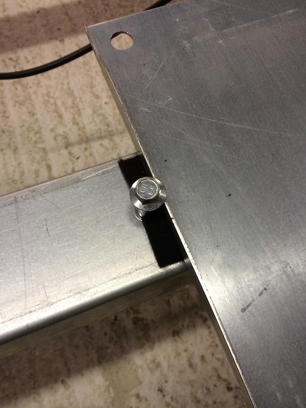

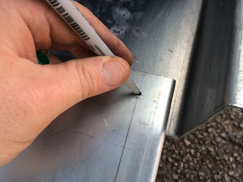

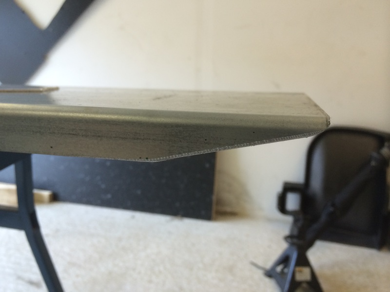

Marked the overlap, where I wanted the ramp to overlap the troughs, and I didn't want a securing bolt to have to turn upside down when the ramps are in use, as I wanted to use the bolt heads that were bolting the numberplate/light metal, to the troughs
Got a piece of ally in the vice, and used a straight edge to put a nice neat kink in it
Happy with the angle, now to mark out meticulously, for the bolt heads
Drill a pilot hole to begin with, the mark through, to check we're in the right place
Happy with that

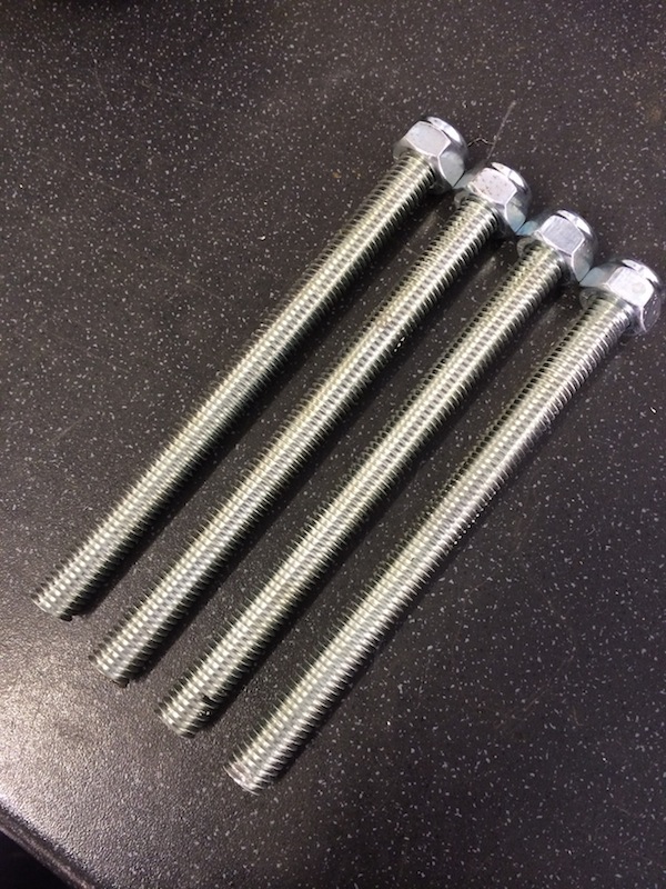

As the largest drill bit I had was 10mm, and these were 17mm bolts, I had a lot of hand filing to do, took me about 4 hours all told, but a well worthy job… my holes saws weren't up to the job, and I didn't want to have to go out and buy kit for this one job
So three hours later, I couldn't be happier with the result

Other end of the ramps is self explanatory, just put a straight edge along the ground to get the correct angle, mark and cut

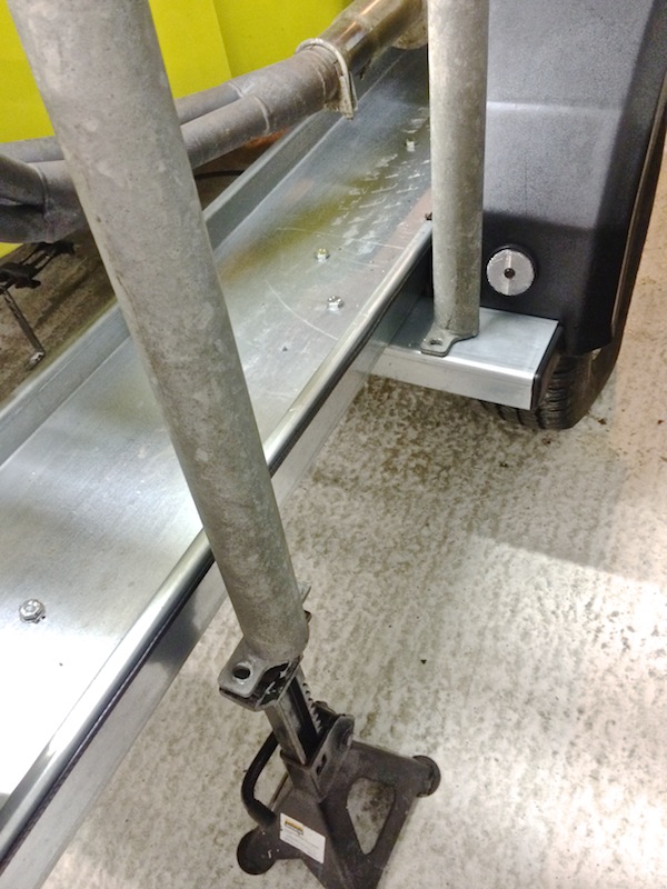

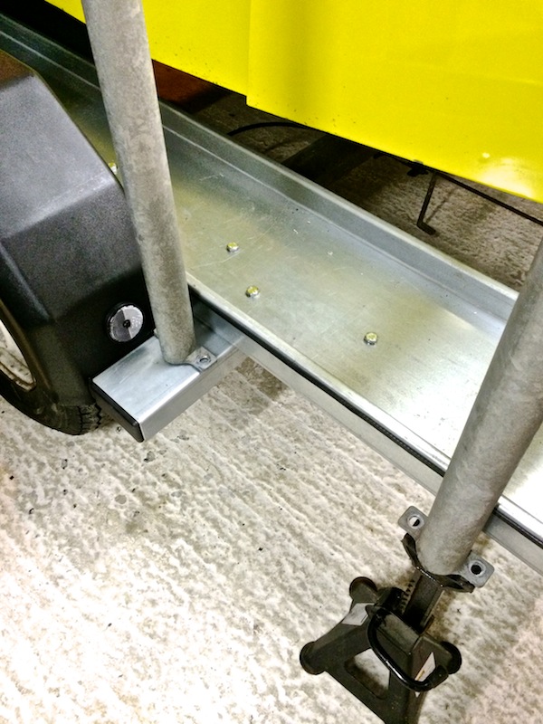

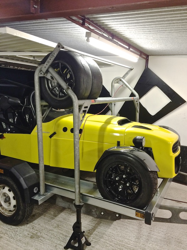

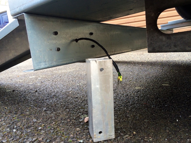

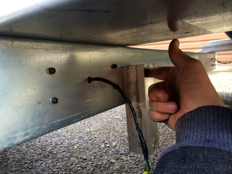

My idea of for legs to stop it tipping, as I don't want them seen, is using this ally box section that I've had for ages, and put a catch & bolt thought it, so it can pivot 90 degrees

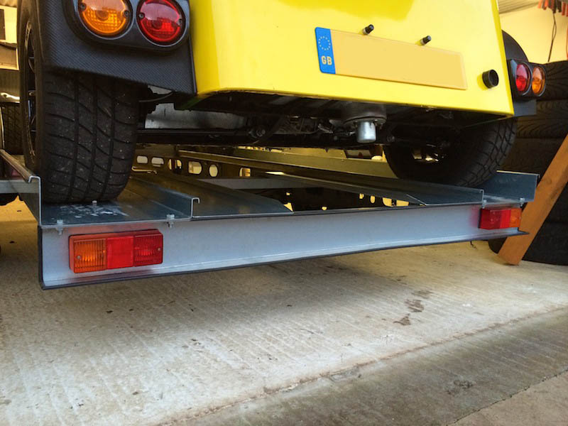

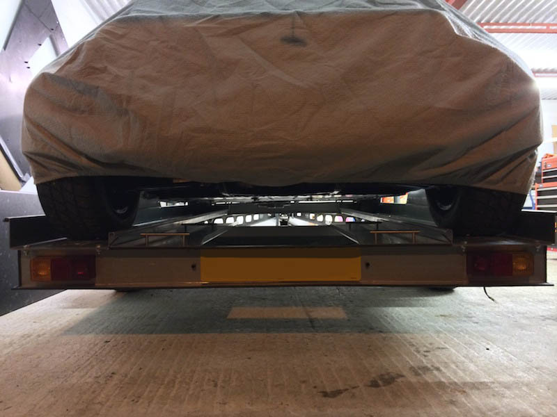

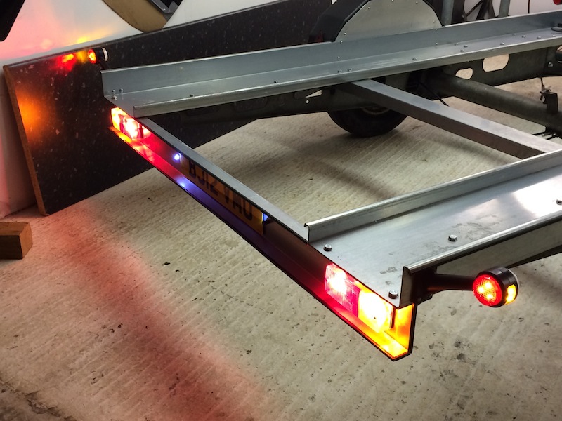

Got my end caps today, to neaten up the trailer to make it look not so 'home made' to to speak… which covers up the bare ends nicely, before & after
Neatening up the rear end with more edging, ready for number plate & lights now

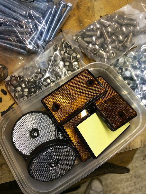

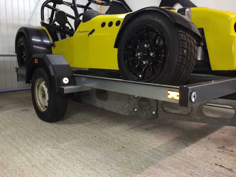

Bought some cheap amber reflectors for the sides, and clear for the front edges of the trailer
Three ambers down either side, front, mudguards, and rear… and the two clear/ white on the front edges

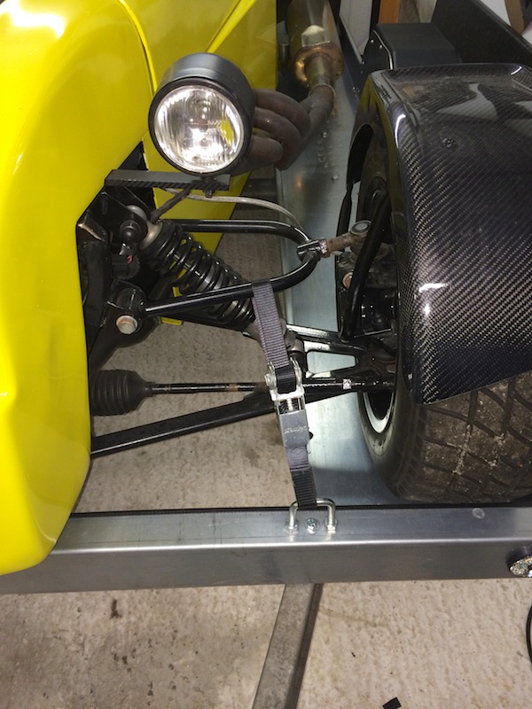

Ending today on the harness tie downs, put them either side of the bolt holding it all together, as I can imagine there is a lot of stress being pulled up on here, so will not bend

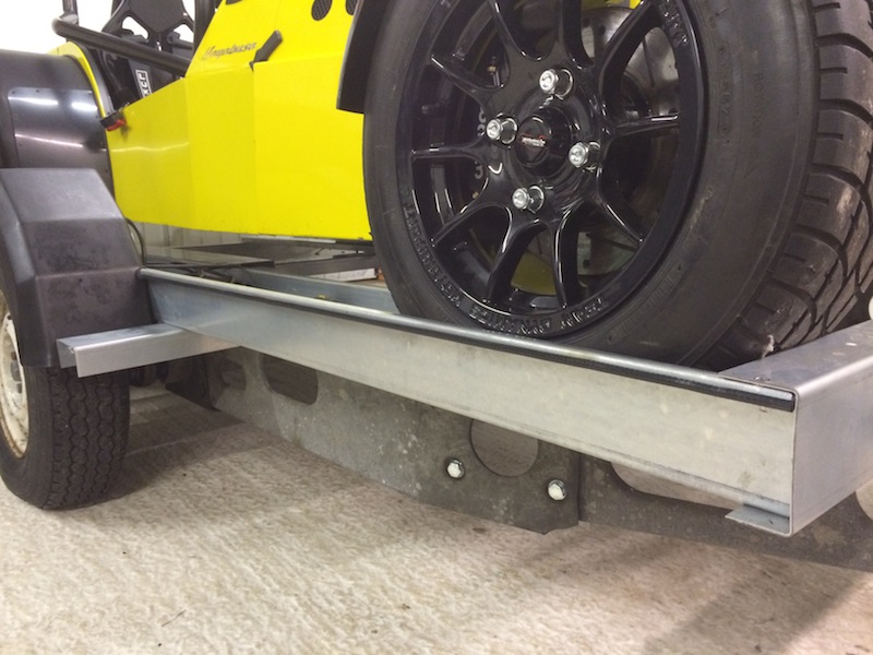

So I spotted a bargain on eBay this morning, and drove up to Lincoln, and snapped up a Brian James tyre rack on a whim, hoping it would fit, and wouldn't be too wide nor narrow

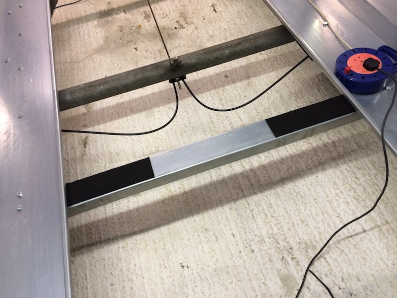

Pretty spot on, all I need to have made up, is two more U sections of galv, similar to those that hole the mudguards, then job jobbed!

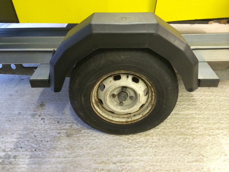

Put a couple of wheels & tyres ontop to check for heights, and fits with no problems, the pivot bar needs extending to the next holes to make it longer, which means it'll sit further around towards the front of the tyres, and not stick up in the air

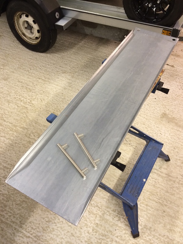

Attention turned back to ramps, not wanting to make too much noise, I had some kitchen door handles that we never used lying around for ages, so I dug them out, to make handling the ramps a damn site easier, looks and works very well, when removing and putting them under the car, nearest to the ground has to be 5.5inches up from the bottom in order to clear the floor when sat at the correct angle

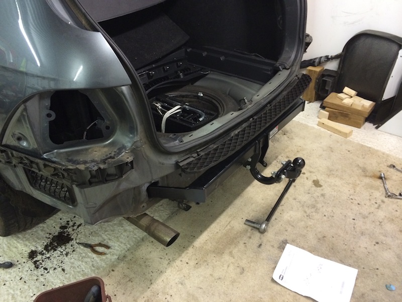

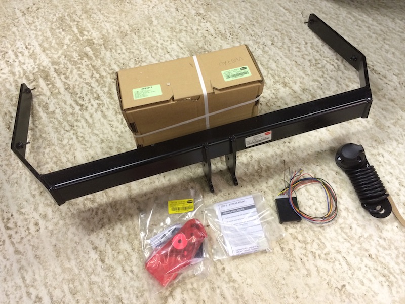

Great service for a tow bar & electrics from P.F.Jones, thanks to daveb666 for doing all the research for me, relatively simple task - not done the wiring yet - but just the metal work
My next day delivery from PFJones

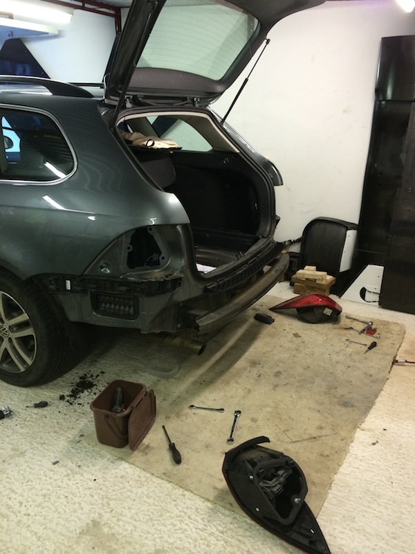

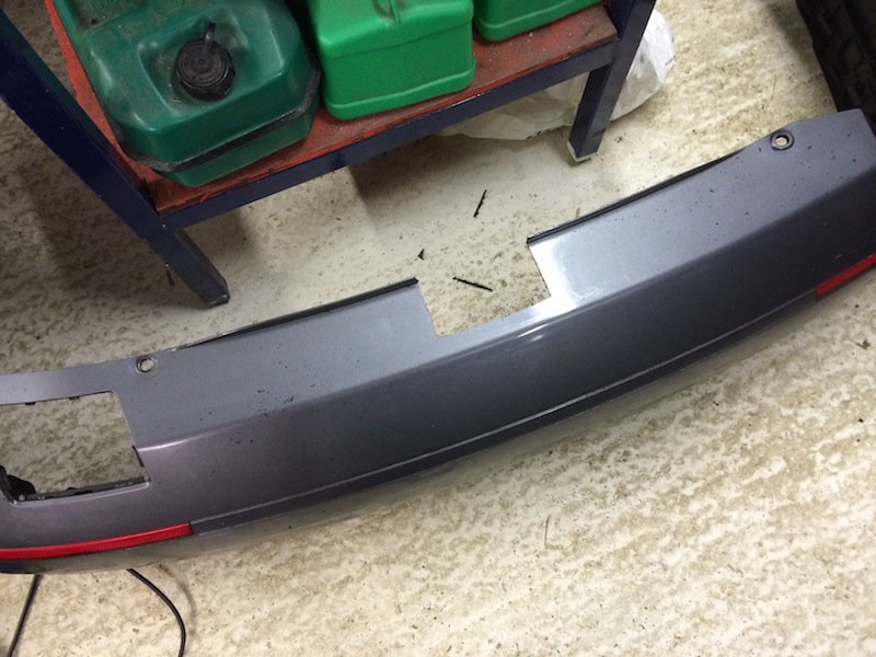

Took about 45 mins to figure out how the rear bumper came off without ripping it off completely, after that it was a breeze and only took a further 20mins to complete the rest of the job lol

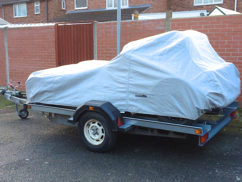

Can I ask what model the car cover is for? And make?
yellowcab
posted on 18/2/14 at 08:31 PM Reply With Quote
Cheers for the reply & comments
It's a 'CoverCraft Noah (Block-It Fabric)' specifically made for a Seven
http://www.covercraft.com/carcovers/noah.html
(video is interesting to explain why they're so good)

I may be being an idiot, but I can't find the seven version on their website. Did you buy it direct?
If you didn't mind, it would be very interesting to see a cost break down of the trailer.

mccsp - I cannot remember where I got the cover from, but I'll have a mooch, I think its 'made' for a Caterham specifically

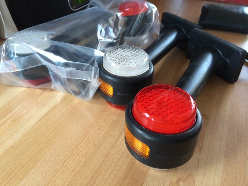

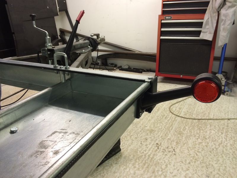

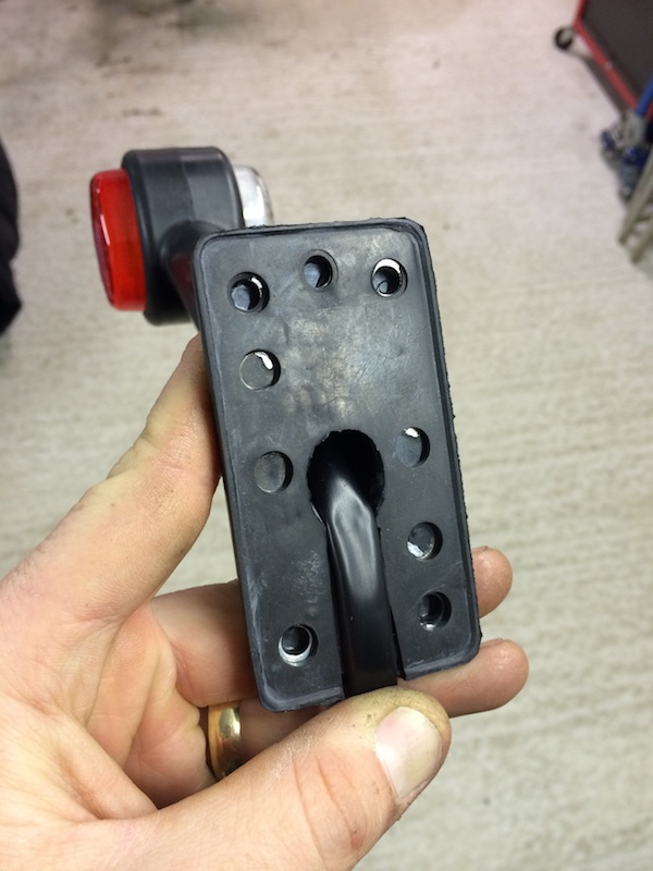

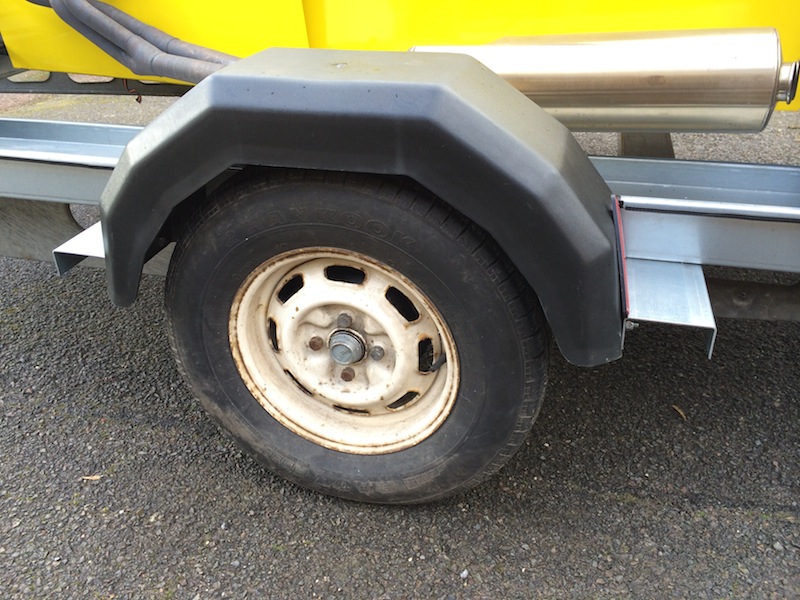

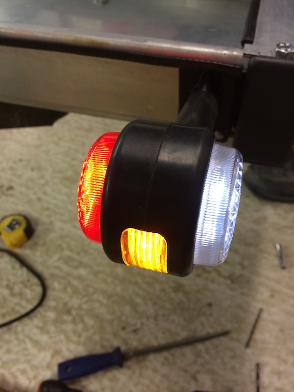

Picked up some bargain 60degree LED marker lights after being persuaded by daveb666 that I should make the sides & front more visible… all four cost £13.50 delivered, thats not even £3.50 each!

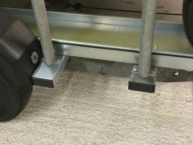

I had the two profiles made by Nat @ RetroPower - thanks pal, for the front feet of my tyre rack to sit onto
All marked, drilled, bolted & end capped

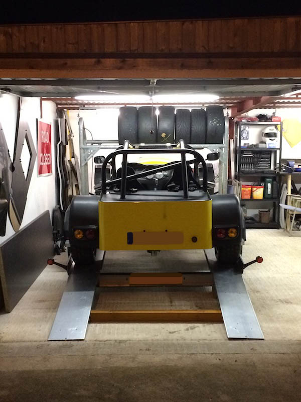

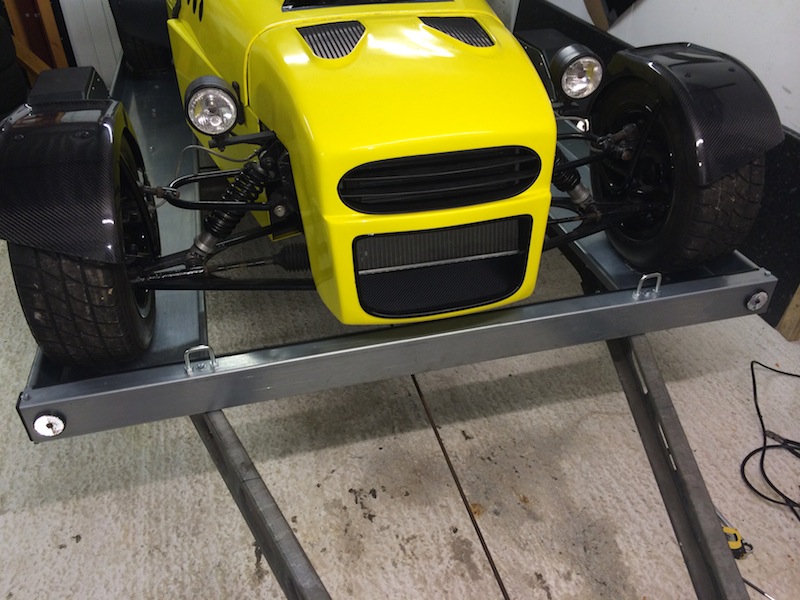

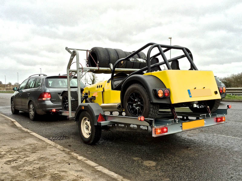

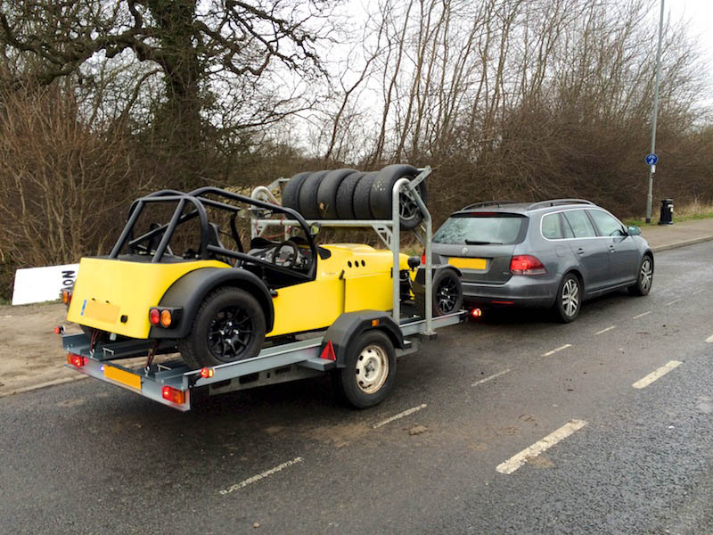

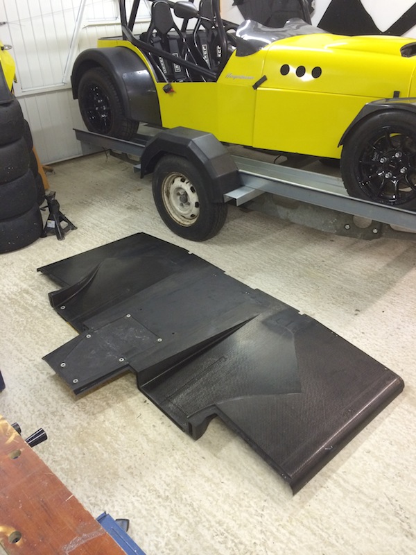

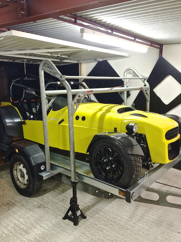

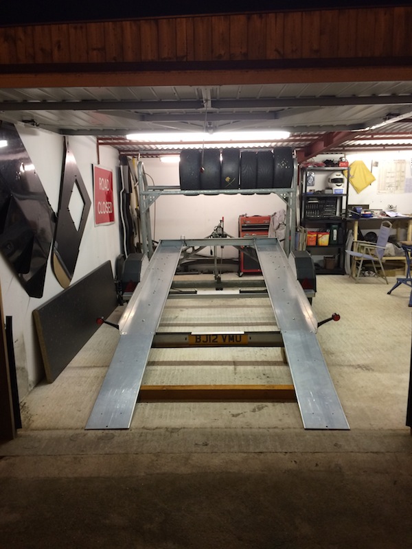

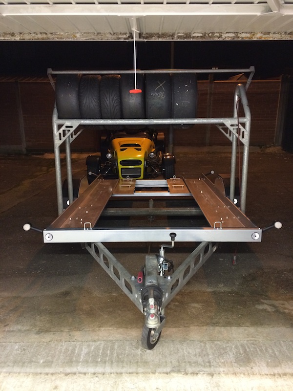

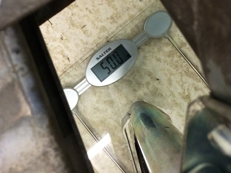

So with the car on, tyre rack over the bonnet with 4 dry wheels & tyres on - the hitch weight couldn't have possibly been any more accurate

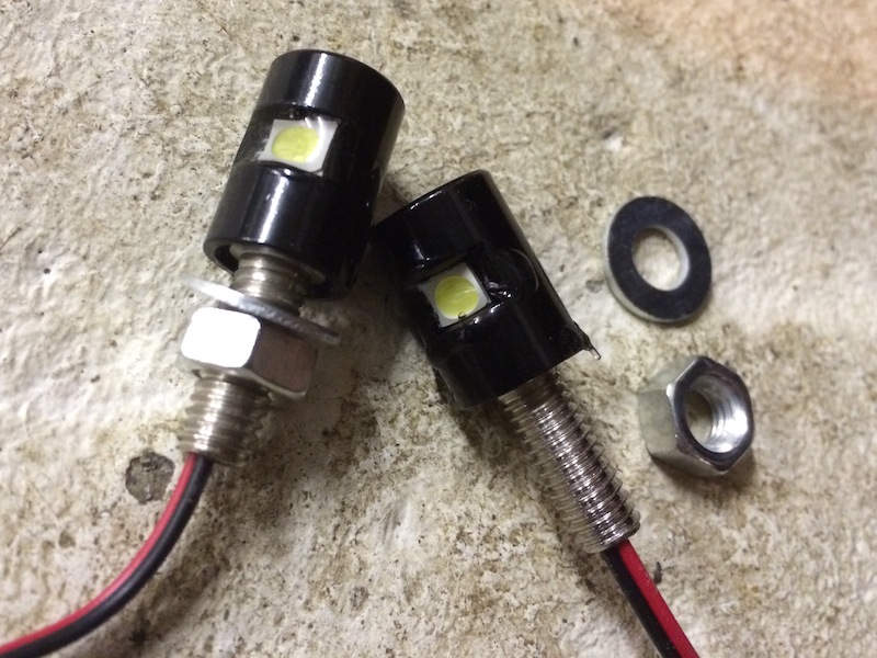

More tarting, bought some bargain £2.99 LED number plate lights, to mount either side of the plate shining inwards to give a more even spread

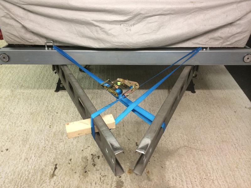

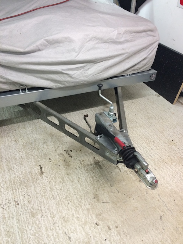

Next up was shortening the A-frame, as it always needed doing but was putting it off, as it was over 2metres in length, hitch off
Strap it up to increase the angle - I hadn't bolted the troughs to the A-frame yet for this exact reason
All drilled & bolted through, now from front of trailer to hitch tip is 115cm

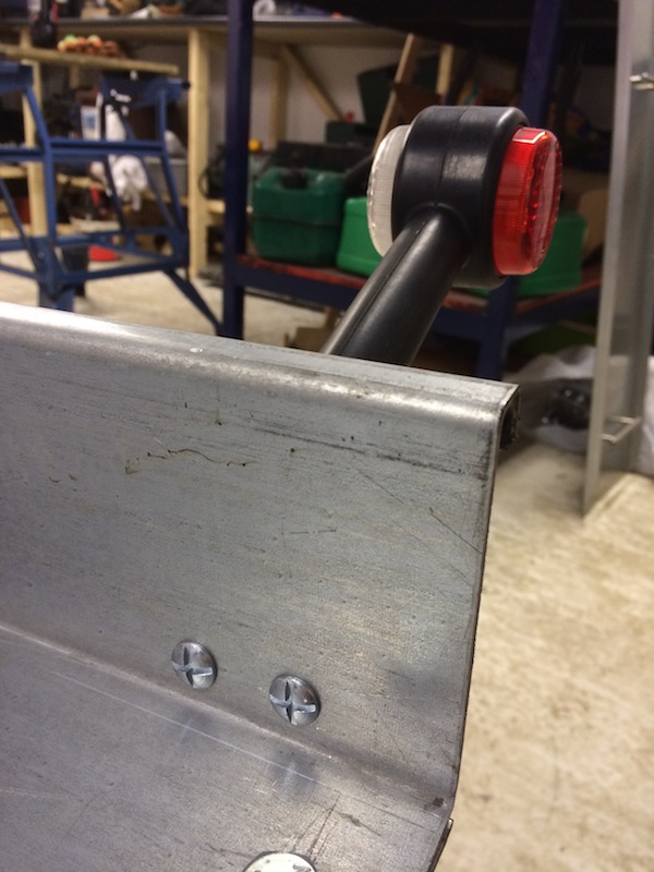

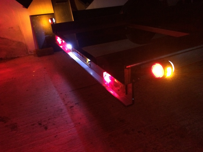

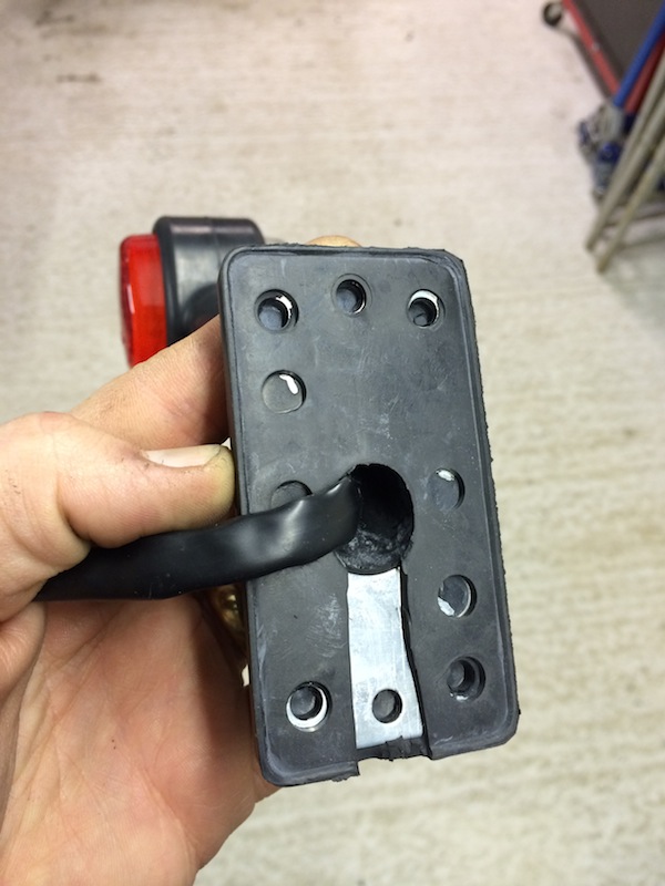

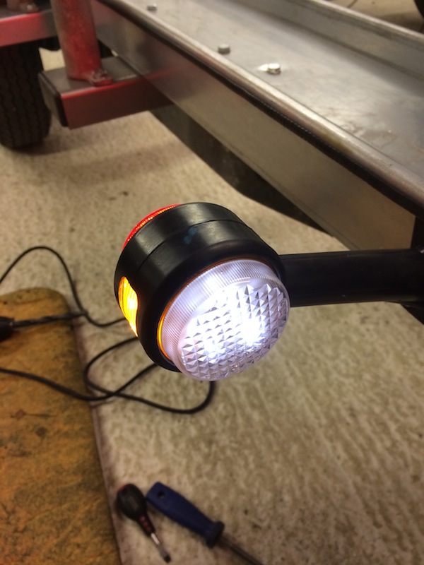

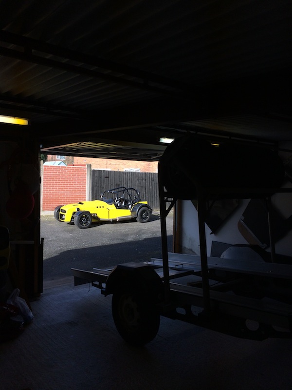

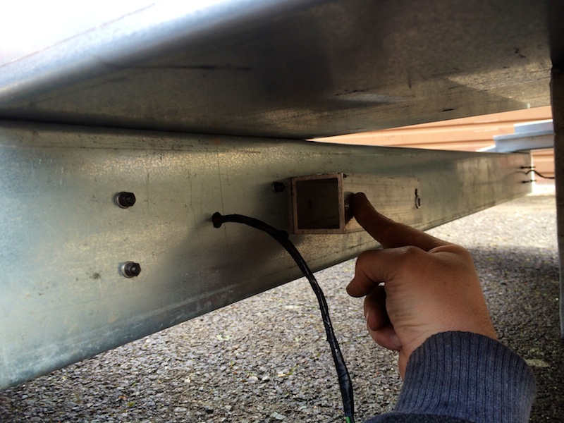

So the marker lights are going to be mounted at the rear, on the sides of the troughs but don't want the wiring to enter where the wheel & tyre sits, so channelled out the rubber backing for the wiring to run on the outside of the trailer and tuck under nicely
Early start yesterday, sun was shining so the car got some warmth - pootled up and down the street a little just to have a feel, first time in nigh 4 months, felt great
Where the hitch had moved back, the size of the Alko chassis where the hitch bolts to obviously increases, as it starts off small and gets bigger the further back towards the wheels it goes, so popped down B&Q (instead of Colin Williams AutoSpares) and picked up some M12 threaded bar, and some M12 nyloc-nuts
Then Mr.CW Auto Spares popped in to say hello

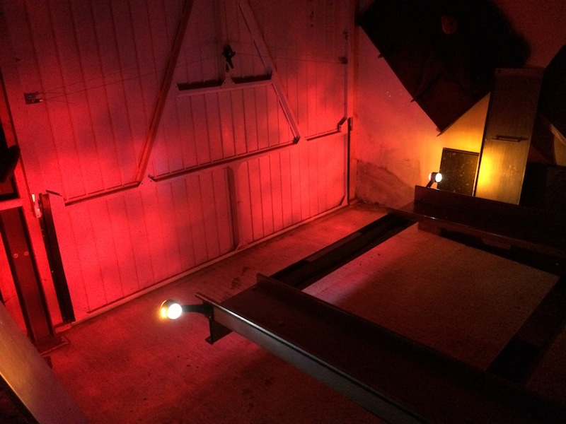

Back to it that evening, testing the markers, look really quite smart for their price tag
Here is the back end of the trough, and the wiring not coming through, you'll notice that there are only two dome headed bolts holding them on - because more luck than judgment but they just fit snug up inside the turnover on the outside of the trough which held them steadier than I could ever hope for
Front one wired up with no visible sign of wiring, these do pass through the trough, and then run up under the from box section, because it doesn't encroach on the car wheels or tyres
Testing testing

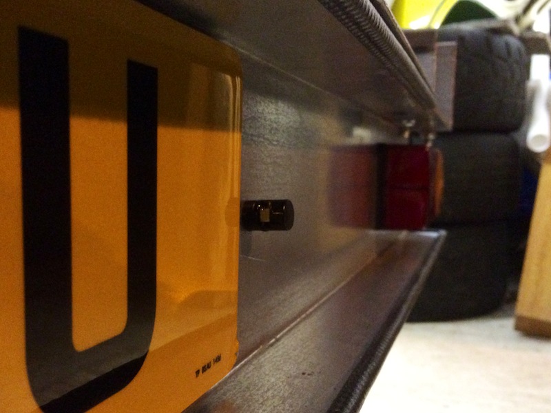

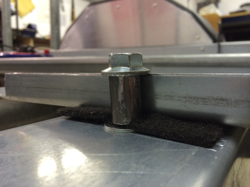

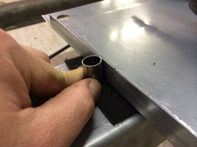

Not keen on rattles, cut some carpet, and Tiger-sealed it onto where the ramps are going to be mounted, to make them silent and easier to slide on and off the trailer
And on the rear too, drilled through the ends, and the number plate board to put the eye bolts in which double up to hold the ramps down
So for in the middle of the car
Cut a spacer the same height as the edge of the ramps, and passed an M12 bolt straight through with an incorporated washer, to use the head as a way to slide the ramp in and it'd hold down… the outside of the ramps is tucked under the inside roller over of the trouhs

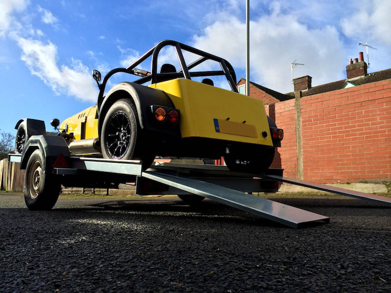

Job jobbed - trailer (almost) complete… now just need to wire the car up!
I can load and unload the car off the trailer with the ramps down and they stay in place, and closer the garage door, which is a good thing to have such short (1.2m ramps)

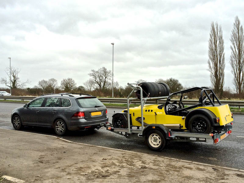

yellowcab
posted on 23/2/14 at 04:50 PM Reply With Quote

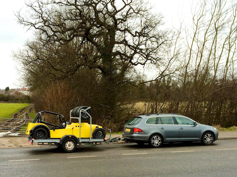

So here is the maiden voyage, no rattles, brakes work well, tows nicely (albeit need wheel balancing and tyre pressures inflated after I've painted the wheels)
Yes there are 5 photos of the same thing, thats how chuffed to bits I am
