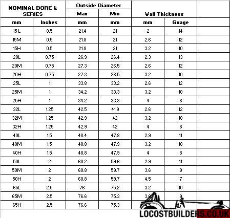

They are ONLY any good for bending thick wall type pipes, preferably B.S.P. pipe, sizes/thickness's should be in my photo archive!
Use them on thin wall stuff and watch it crush & mush up!
