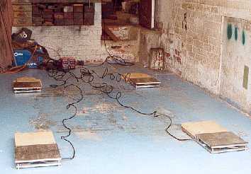

| posted on 19/11/06 at 08:41 PM |
You doing corner weights on Bond's Vanquish again?
