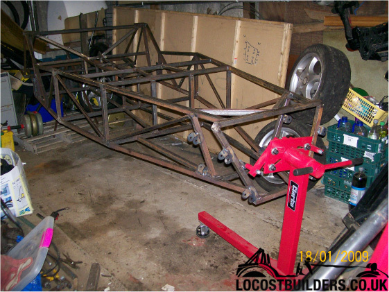

Daddylonglegs
| posted on 27/2/09 at 06:24 PM |
Not sure if this'll help:
Piccy
but where I've attached my chassis to the stand, just use long bolts/threaded rod to attach the engine via the gearbox flange holes as already
mentioned.
I didn't think it would be man enough to do it but it really does work
