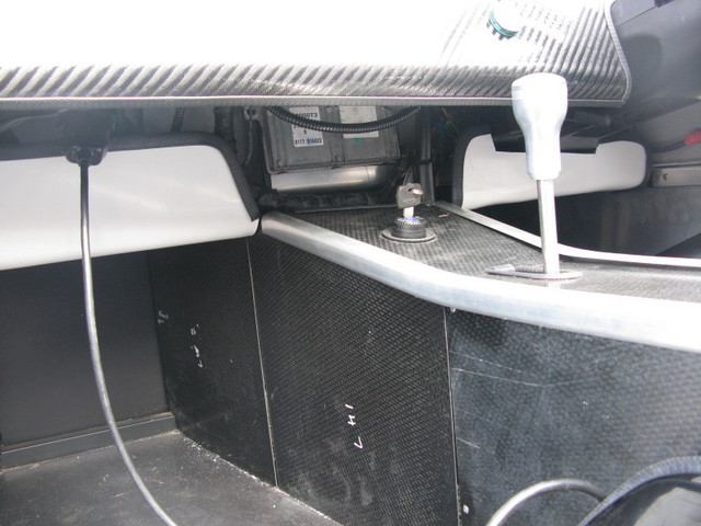

| posted on 14/9/09 at 11:57 AM |
You have any pics of your interior?
twybrow
| posted on 14/9/09 at 12:10 PM |
As you can see - you can notice a few scratches etc on the panels that came from the used bit of Alu i moulded onto. Also, I was limited by the size
of the material I had to hand, so I made mine in 3 pieces (which makes fitting, removal and inspection a lot easier!). It is now a lot tidier than
that looks, with a thin strip of black tape over each join.
