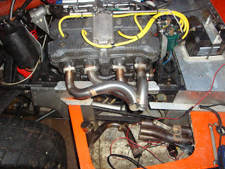

Anyway, here is a photo.
The flange welds on to the point where the 4 pipes all come together. The lengths are not equal, but neither is the manifold that Big-CC sell for the gsxr1000, so I am not too worried about that and they are similar in length (except 1 and 4).
The good thing is that there are not many welds and its all pretty open. Lots of grinding to do within the collector area too, but it keeps me out of the house!
