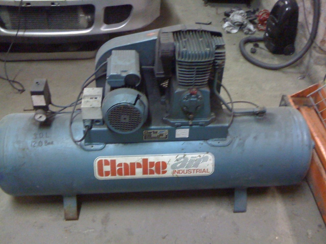

I've a Clarke se15c160 compressor to try and get rid off, but don't know the voltage/power supply requirements.
Does anyone know what this is? I'll post in the sale section once i know all the details.

is it definitely se15c160
could it be se15c150?
if it is, then its the same as mine, 230v, single phase with a 3hp motor, so needs a 32amp supply. got mine on its own circuit breaker and 32amp blue plug

Definately a 160, It a good 8 years old, I think I've found out as it's got a switch box on the top.

seems to be the same as mine power wise.

Its the same as mine which came fitted with a 13amp three pin plug which runs off my normal ring in the garage!

It's amazing what you can find out if you read, the plate on the motor says 3hp, 1 phase. I'll post in the sale section then.
