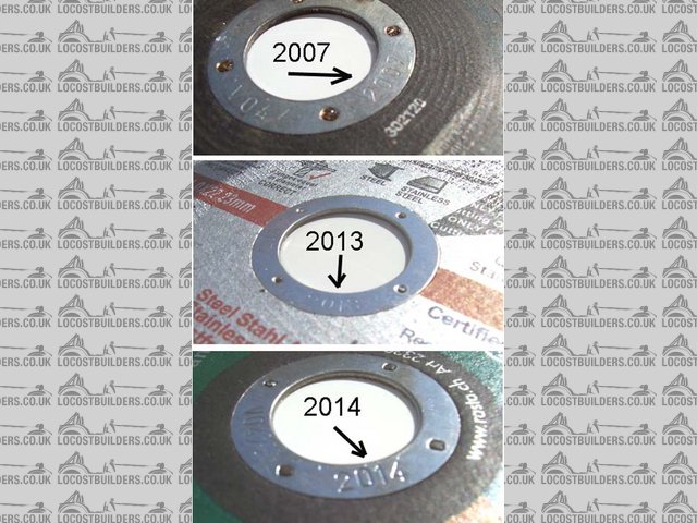

907
| posted on 11/9/11 at 05:48 PM |
I've just had a look at the ones I have and all three makes have a year
stamped on the inner steel ring.
I must confess I have never spotted this before.
The top one is an old half used one but I have no idea when I bought it.
I'll just chuck it in the bin to be on the safe side.
IMHO a grinder with a cutting disc should be held with two hands.
One on the grinder body and the other on the side handle.
The work should be clamped solid.
Holding the work in one hand and the grinder in the other is asking for trouble.
