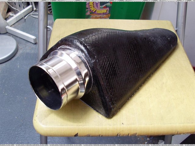

Airbox will be something like this - but shaped / profiled to fit my layout

With reference to the hose connector, I purchased a cheap cold air tube from eBay that had 2 spun ally ends, and bonded one to the inside of the
box.
