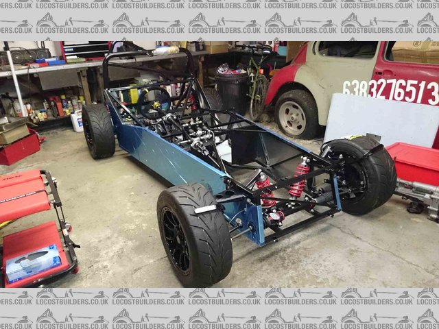

| posted on 2/5/19 at 08:35 AM |
Yes that is possible.
I had a bit more space to start off with
  Need more space!
and even more after the old Striker was sold!
However you could build up to this stage
  Touchdown
and then with a person on each corner put it on its side and as you say roll it out on a dolly of some sort. You could go further before you move it
as this stage was only part paneled and you could also add the wiring loom.
If you want any measurements taken on the chassis etc just ask
