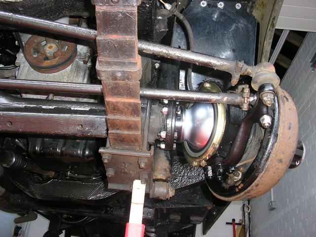

It looks like I'm going to refurbish these suspension plates off my series 3 as replacements are coming in at around £50 a corner. The bottom of the shock absorber mounts on to the round pin.
I'm planning to cut out the round bar (hopefully!!) and weld in new as the plates are ok. It looks like 3/4" and was wondering what you might suggest for the grade of steel (to be MIG welded on). Not sure if it was just mild steel originally or likely something with higher carbon content?
Options might be bright steel bar, or EN9 or A36.......
Any suggestions? And any other advice, especially if you have done this before.

The pins are way stronger than the dampers which I've actually snapped the eyes off before. None of the steel on a series 3 is anything fancy. A good alternative is replace the pin with a bolt with the head removed and fitted with a castellated nut rather than split pin and washer. Makes fitting a lot easier and gives some adjustment to the bush compression.

As I said , EN9 is a bit overkill. S275 would be okay.

No, I haven't replaced my pins, they weren't/aren't too corroded. Only issue has been removal of corroded split pins, etc. The rears are mounted directly onto the axle casing, so nothing comparable at that end, 109 inches away. Top mounting pins are tubular with a bolt running through them at either end of the chassis, so if that's good enough for the top....
If I (I, not you) was to replace the plates, I'd (note, I) do so feeling that any commercial replacement probably won't be as good as the original, so I'd repair. I'd replace the pin with EN3B stock bright round. Choice simply because that's what I've usually got to hand, it's definable material, welds beautifully (MIG or TIG) and machines well. I might even think about a tube with a bolt running through it, probably after too much beer.
