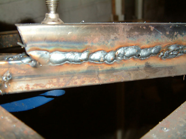

Got a MIG the other day after not getting on with the ARC. WHAT A DIFFERECE!!

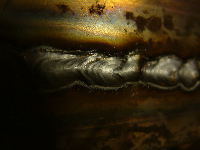

posted on 1/3/05 at 09:30 PM Reply With Quote
looks like a good weld to me. MIG always looks a bit messy (splatter and the likes) but its easy to get a working result.

This is scrap but I had to do some chassis so I put one more piece on
Any advice to get it better much appreciated. I ran out of gas quickly as I only had disposable bottle - got very spitty when the gas went!!
posted on 1/3/05 at 09:33 PM Reply With Quote
are you using co2 or an argon mix?
flak monkey
Mig is much easier than MMA yes...
Welds arent bad just need to go a bit slower i think...or turn the power up a bit, to get a bit more pentration...(ooo er) just looks like the welds are standing a bit too proud from the surface (though it could be the pics)
Then just practice doing the longer runs in one go but i was told not to try more than 100mm in one go...

posted on 1/3/05 at 09:37 PM Reply With Quote
They are about .5 - 1 mm proud of the surface.
Gas is SIP Mildsteel disposable - I assume just CO2

posted on 1/3/05 at 09:45 PM Reply With Quote
Take it a little slower, the power is probably about right, I would spend more time experimenting with wire speed first.

posted on 1/3/05 at 09:46 PM Reply With Quote
Welds look good mate. Turn the power up and go a bit slower to get a flatter weld. What welder have u got?? I run the disposable c02 bottles they last me ages. Ive got an SIP migmate turbo 130 running .6 wire.. I run it on max most of the time.
I agree with mark if your lens is to dark youl have trouble seeing.

chunkielad
posted on 1/3/05 at 09:51 PM Reply With Quote
think the lens is a 10. The welder is a Cosmo 130 GasGasless (made by SIP).
I will try slower - didn't want to blow a hole so was a bit fast I suppose - will add a bit of wire speed too. I did about 3 hrs overall with the one tiny bottle. I thnk I'll get a BOC Argoshield....
clbarclay
posted on 1/3/05 at 09:55 PM Reply With Quote
On a peice of scrap similar to what your welding, see how far you can push it. Its the only sure way I know to find out just how much current you can use.
Mark Allanson
posted on 1/3/05 at 09:57 PM Reply With Quote
Blow as many holes as you want (on scrap), then you will be able to see the tell tale signs just before the meltdown, just trigger off before the hole and restart an fraction of a second later. Get yourself a EW9 lens - once you have it , you will see what I mean
