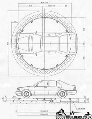

Anyone any experience/ Knowledge/ plans for car turntables?
TIA, Ian.
Errrm, I was thinking more along these lines!
[img]http:// [/img]
[Edited on 27/6/05 by Ian Pearson]

Check out an old disused rail yard for a decent turn table.
It wouldn't actually be hard to make one. I designed some gazebo turntable tracks for garden designer which used six 125mm cast iron industrial
bogey wheels which ran on a rolled angle iron track.
Cheers, Rorty.

Ian Pearson
| posted on 28/6/05 at 09:42 PM |
Have you got some sort of 'Tracy Island' Thunderbird thing going on ?
Thanks for the replies chaps. Thinking of changing the access to the house, and as space is going to be tight, I thought of a turntable either in the
garage, or drive, to make life easier. Did an internet search, but they all look a tad expensive. Not sure if my design skills are up to the job,
hence the question.
Regards, Ian.
Rorty
| posted on 28/6/05 at 09:56 PM |
Ian, it wouldn't be too expensive to form a shallow pit (with concrete footings) and bolt down a rolled angle iron track as I mentioned before.
After that, it's a simple job to make a circular frame to mount the wheels to and cover with something like treadplate.
Cheers, Rorty.

Rorty
| posted on 29/6/05 at 08:29 AM |
Let me know off-forum if you want a few pointers.
