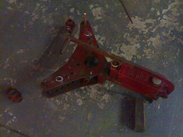

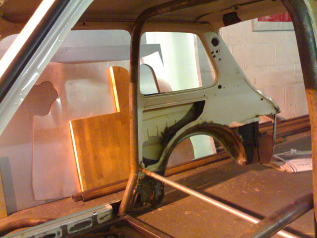

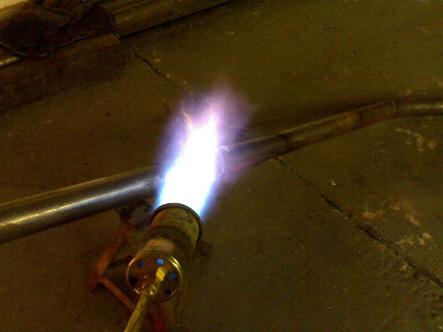

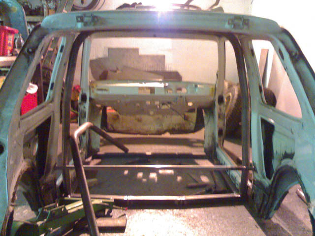

NS Dev
| posted on 26/2/07 at 01:29 PM |
Well....................
  tube bender
  tube anneal
  main hoop
  main hoop 2
That's 45 x 2.5mm CDS, and a 15 tonne hydraulic bender used carefully, after annealing the normalised CDS tubing.
