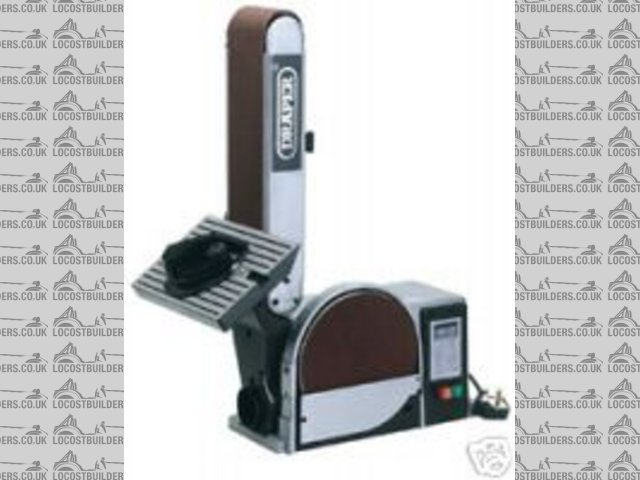

Belt+disk sanders
I was wondering if one would be a good investment when building a Locost. I was thinking for taking off burrs on cut tubes and tidying up brackets
ect.
They don't cost much..

| posted on 5/9/07 at 03:21 PM |
The cheap ones are mainly intended for light use on wood. The first time I tried using my mates one it stopped the belt. You get what you pay for was
never truer.
Now having said that, a cheap B&Q belt sander of the type that you hold, held upside down in a vice works a treat and will really shift metal with
a coarse belt. Use blue zircon belts not the red garnet ones. HTH.

| posted on 5/9/07 at 03:29 PM |
I've got a clarke/draper one, it's handy, but not essential, also where I have it sited I sometimes don't have room to use it, so
use an angle grinder. which works just as well if I'm honest.

| posted on 5/9/07 at 04:32 PM |
Flap discs on an angle grider do it for me and are long lasting - if money is tight an angle grider is the one tool you can't do without in my
opinion, although a belt sander is useful for many tasks.
A disk sander would be way down in my order of priorities.

| posted on 5/9/07 at 05:01 PM |
I got one from B&Q supertore with normal grinder on the left side and vertical belt on the other side.
Was under £40.
It's been one of the best things I've bought.

Fred W B
| posted on 5/9/07 at 05:57 PM |
Seconded, this is mine, I find it extremely usefull. I have had to replace the switch though.

| posted on 5/9/07 at 07:43 PM |
I use the Machine Mart model to finish off all the angles on tube ends.

| posted on 5/9/07 at 07:59 PM |
I bought a belt sander from Lidl. It came with brackets for bench mounting and it has been bolted to the bench since I got it. I wish I had it during
the chassis build and I use it pretty much everytime I work on the car. cost £19.99 and was deffo a good buy!
