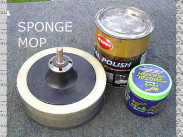

907
| posted on 26/4/08 at 07:44 AM |
Hi Steve
Don't be tempted with kits. They contain little wheels & mops more suitable for bike engine covers etc.
Sponge mops have an M14 thread in the back plate. An M14 stud turned down to suit a drill chuck and a nut off a grinder makes an arbour for a
drill.
Buy the hard ones as the softer ones are for paint.
DON'T USE IN A GRINDER! They disintegrate at 5000 revs. (Don't ask)
Good for getting unmarked ally to a nice shine.
Paul G
another post to follow.
