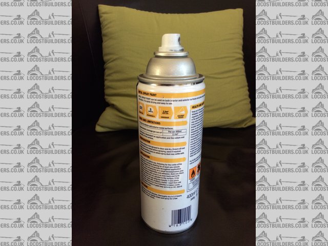

Ok, did I say B&Q? I meant Wickes of course!
This is the stuff:
[img]
![](/galpreviews/IMG_0148.jpg) ![Description](/gallery/IMG_0148.jpg) Description
[/img]
[img]
![](/galpreviews/IMG_0149.jpg) ![Description](/gallery/IMG_0149.jpg) Description
[/img]
I found a can of acrylic clear coat and tested a small area and it was a very blotchy result, and there was a small run that seems to have dissolved
the paint ![](/images//smilies/sad.gif)
