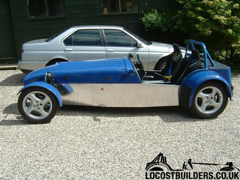

Had the bonnet open taking some photos of my TBs so took this one for you. I found that steel csk screws rusted after less than a year so I now have
ali ones - apart from the one I did up too tight!
