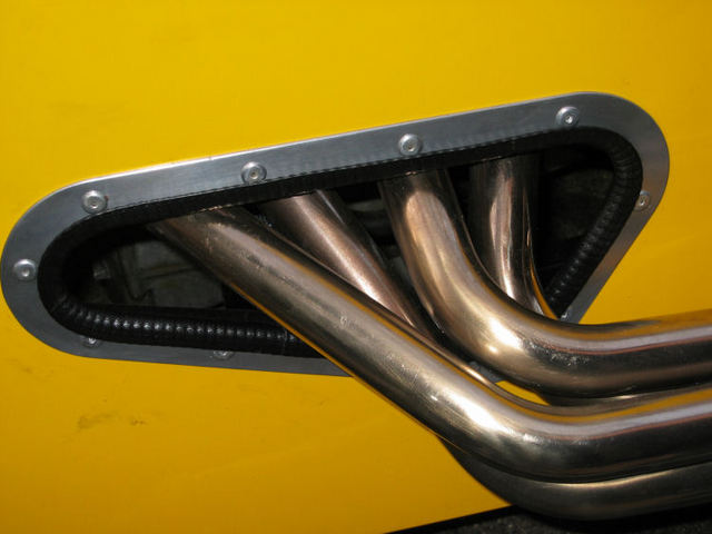

| posted on 8/11/08 at 11:52 PM |
I've only got about 10mm clearance at the closest point.
And I'm pleased to say my bright yellow fibo has not discoloured.
In fact 2 years on and I've still got my SVA trim on and that's not burnt away either!
The plate only needs to be thin to hide the edge
