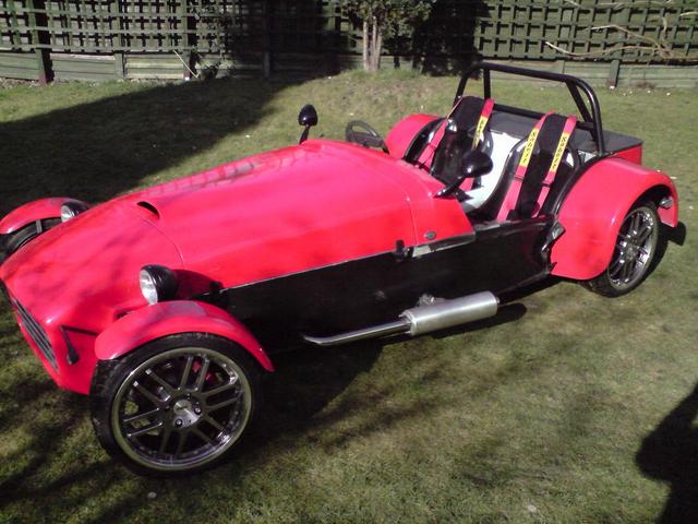

tomgregory2000
| posted on 7/9/09 at 11:44 AM |
  Side complete
Here you go
The can and short pipe is for sale if you want it, it got me through sva as i fitted a home made db insert that will come with it.
Im only looking for £20 inc delivery
Can get pics of it if you want
edit: can is off a GSXR1000
[Edited on 7/9/09 by tomgregory2000]
twybrow
| posted on 7/9/09 at 11:46 AM |
I have 3 cans I can switch between, the cheapest being an R1 can, the most pricey being a CBS 7" can. Personally, I prefer the larger can for
look and sound. It was used for SVA, so noise is ok. The only downside is the cost - £200!
I think really stumpy cans/short link pipes look a bit odd, but they do make it less likely for your passenger to burn their legs!
