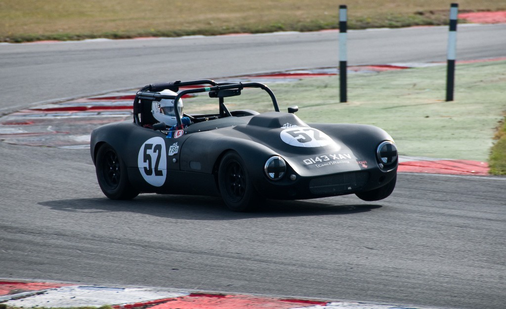

My Fury racecar is matt black:
It was easy enough to paint, but it's a bugger to keep clean, it's almost impossible to touch up any new areas properly as the degrees of 'matt'ness change every time I stir the paint, and as you say you can't polish out any defects.
That said, I said reckon it looks rather good. And it *was* easy to spray...
