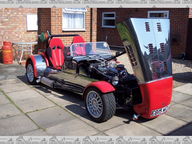

Benzine
| posted on 17/6/10 at 11:18 AM |

Benzine,
Cool Bonnet! I was thinking of doing something very similar myself. Couple of questions.
I would need hinges that can have the bonnet and cone taken completely off as well as tilt. Does your have this facility, if so what hinges have you
used?
Did you put extra strengthening in the bonnet to provide rigidity?

Benzine
| posted on 17/6/10 at 01:56 PM |
used?
My hinges don't have that facility, if I wanted to take it off all together then I'd have to undo 4 small bolts on the hinge (one side of
the hinge is welded to the chassis, the other side is bolted to the nosecone) No extra strengthening other than beefing up the fibreglass where the
cone meets the bonnet, seems plenty strong enough
