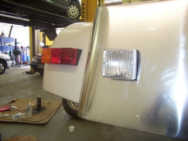

Mark Allanson
posted on 30/5/04 at 06:42 PM |
I used a wood boring bit for the wiring holes, and a std HSS for the screw holes, both at VERY slow speed.
![](/galpreviews/a112318-Lamp Marking.JPG) ![Rescued attachment Lamp Marking.JPG](/gallery/a112318-Lamp Marking.JPG) Rescued attachment Lamp Marking.JPG
Mark Allanson
posted on 30/5/04 at 06:46 PM |
... and finished
![](/galpreviews/a112322-Lamps LH Finished.jpg) ![Rescued attachment Lamps LH Finished.jpg](/gallery/a112322-Lamps LH Finished.jpg) Rescued attachment Lamps LH Finished.jpg

Northy
posted on 31/5/04 at 07:16 PM |
Ben,
You see the gap between the Stop/Tail and main tub, I'll be fitting reflectors there for SVA, then they may fall off and get replaced with two
reversing lights same style as the Stop/Tail and Indicators.
The Fog then might flip upside down and move to the centre line.
![](/images//smilies/bigsmile.gif) ![](/images//smilies/bigsmile.gif) ![](/images//smilies/bigsmile.gif)
