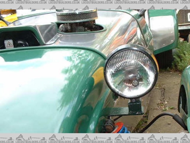

posted on 7/6/04 at 05:46 PM Reply With Quote
I found that making the bonnet slightly small, the tension pulled it to shape Rescued attachment Albertz4.jpg

posted on 7/6/04 at 06:20 PM Reply With Quote
Mark,
Didn't work for me - also, your nose and scuttle tops are more rounded than mine, which are only slightly curved (which doesn't help!)

posted on 8/6/04 at 05:53 PM Reply With Quote
I strapped to the car with ratchet tie downs, adjusted the bend by hand - I just got hold of it and squeezed it over the required bend until it sprung back to just right.
