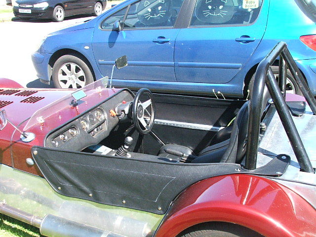

i've been thinkin about making some halfdoors but with a polyscreen head height, but i'm guesing i'd need to tie it into the
Aeroscreen otherwise the wind will just come down between the gap
hope smart51 doesn't mind me using his piccy of his halfdoors.
  half door viewed from above
or would just half doors like smart51's make a difference to ear wind noise
what do you guys/girls think

bi22le
| posted on 10/5/11 at 03:47 PM |
I have half doors and a small (but not aero) screen. Originally my doors curved up to meet the top of my short screen but due to the height blocking
the wing mirrors I cut the half doors down to be level in height but not meet the screen. The mod made NO difference to wind noise or wind level in
the cockpit.
When I do track days I often remove the half doors to allow more elbow room. You really notice the difference then. Its not from the wind (although
you can certainly feel turbulence around your arms and seat belt straps flying everywhere) as such but from the road noise. I hear comparably none in
my car when the half doors are on. To the point that I left them on for my most recent track day and just got used to the lack of elbow space (i
didn't really notice anyway!). Also to prove the point I never noticed how long my harness straps were until the half doors come off. I had to
tape them to my harness because they were flapping all in my face, I have no such problems with the doors on.
EDIT: I have just noticed, look at my Avitar and you will get an idea of the very small amount I removed and how similar my screen is to an aero.
HTH
Biz
[Edited on 10/5/11 by bi22le]

good to know they do make a big difference, i guess as a start i could just make half doors without the window( as in smart51's) and see if it
help
