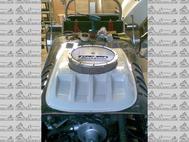

I've had to fit a 'bulge' to the bonnet to clear the V8 engine. Thankfully I had a GRP one lying about in the garage, so it will do.
I'm just wondering whether or not to open the vents? The engine-bay temps are ridiculously high... would opening the apertures help?

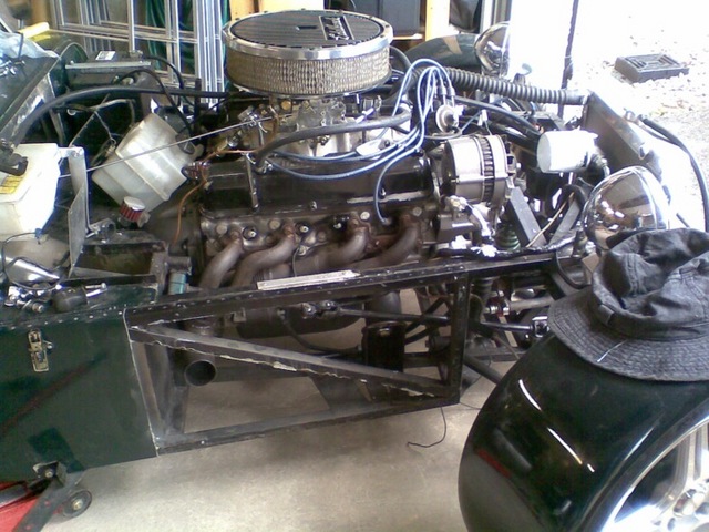

The rad-heat is minor. It's the heat from the exhaust manifolds that's causing problems.

They were, but the wraps were flaking to pieces, so I took them off (I never put them there).

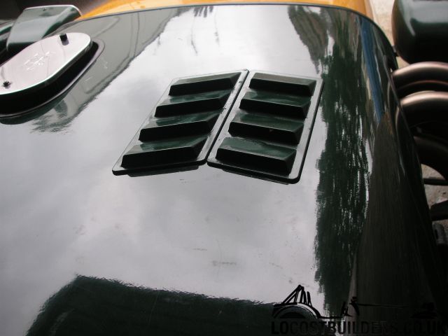

Hi Scootz, this is a picture of how I overcame the same problem with my V6. Just made up a couple of alloy vents as shown, worked a treat. Excuse missing gaurd, lost on the way to Stoneleigh, :-) HTH Ray

I have a vent right above my manifold. the amount of heat distorsion bellowing out of it when im standstill is incredible. let the vents do the work when stand still and the rad do the work when moving.
solves all problems.
word of warning. too many vents and lots of speed means a bonnet lost at 100mph on the motorway!!

Vents directly above manifolds are of massive help when at standstill (when your cooling load is at it's highest, ran fan or not). Put them on mine and it massively reduced the spikes in temp I was getting when queuing in traffic after a blat...
HTH, N.

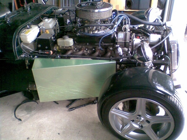

Side vents have been made and fit well...
