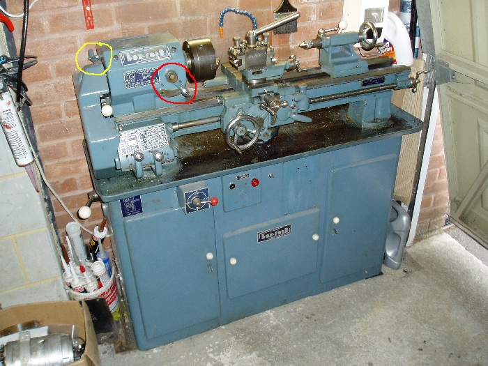

you won't go too far wrong with a boxford as stated, tough as old boots and nice and compact for a small garage. Might be luycky and pick one up in your budget, but stretch that a bit and you should get a nice AUD model???
here's mine tucked away in my single garage
http://www.mig-welding.co.uk/forum/attachment.php?attachmentid=7244&stc=1&d=1233818114
