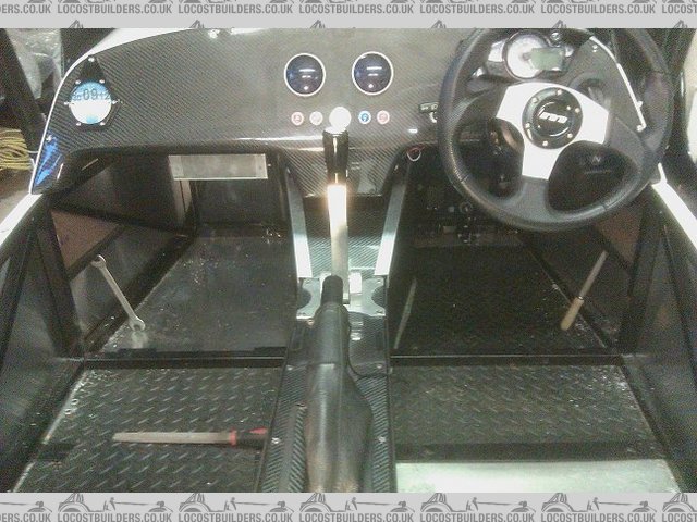

Rollcage Progress:
Thought I would keep a track of my progress on this thread.
Rollcage tubes all arrived from Tom at Tube Bender. Got the rear hoop tacked onto its plates then the rear backstays cut to length and the fishmouths
cut and fitted. Tacked the bottom plates on that will be used to bolt through the chassis plate in the rear. Used the tube mitre software to make
templates for the notches.
  Rollcage rear hoop RB
  backstay detail RB
  Rear hoop side on RB
Then did the diagonal. Bit tricky as the tubemitre template is not much use when notching to join on the inside of the bend! Lots of filing later had
both ends sorted.
  rollcage rear diagonal RB
Spent yesterday cutting the front hoop to correct height and then cutting the fishmouths in the bottoms of the 2 uprights.
Notched the ends of the roof bars today. Did the rear ones, can't do the front till the front hoop is in and then they can be cut down to the
right length.
  Roof bars cut one end RB
So far so good. Ready for my mate the welder now to start replacing gaffer tape with metal!
Rich

| posted on 18/3/12 at 10:07 PM |
Bit more progress on the rollcage.
Welded some 20mm box section to support the rear plates for the backstays. Tacked the plates on ready for final welding.
Tacked more box section and the plates into the chassis for the front mount. M12 boss welded into the plate to take the bolt.
Tacked the tubes to mount the front hoop to the plates.
This is what it looks like now. Next job now the front hoop is in is to cut the roof bars to length and notch them ready to be welded.
Getting there. Should be welded up by the end of next week hopefully. Just the sidebars to cut as well.
Rich
