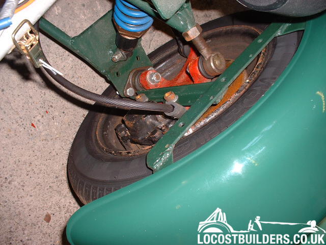

| posted on 5/9/04 at 11:11 PM |
It's usually because the weld causes the metal to turn brittle as it flexes between the stiffer round tube and the flat. 5mm flat should cure
it. I used some angle instead and bolted it to the caliper bolts, an idea from Ray Hudson. Much simpler and strong too.

splitrivet
| posted on 9/9/04 at 09:42 AM |
quote: Originally posted by JoelP
quote: Originally posted by splitrivet
Made mine from bent conduit and used the caliper bolts for mounting...
what do you mean by bent conduit? dimensions and material please! looks like a simple enough thing to make. i expect the weld between the two bars
would benefit from a small triangular brace, but it might not be necessary.
By bent conduit I mean conduit which aint straight
As for dimensions it was made from just standard electrical conduit which I had knocking about in the garage,I didnt work to a design or anything I
just bent it up to suit the task.
If you look at the pic you can see the on finished article I did include a triangular gusset,I tested the first one I made by fitting it then sitting
on it and take it from me Im no lightweight.
