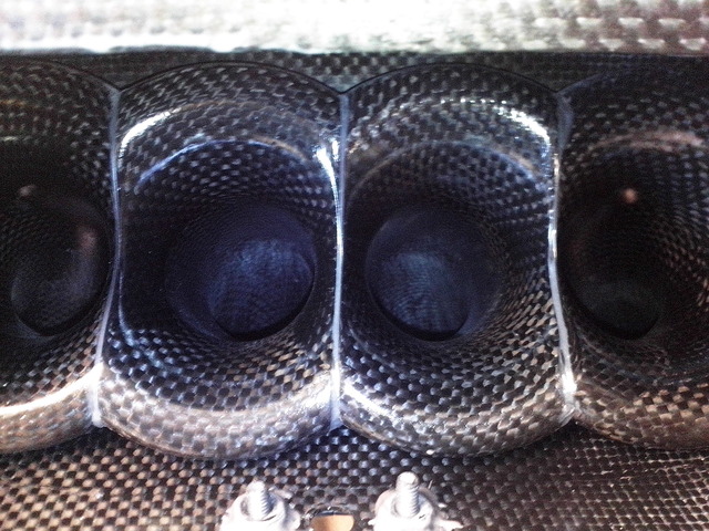

Go down your local Canadian Tyre and buy yourself a can of clear laquer then apply it to your CFRP part sanded to no more than 300 grit and you can
have a fantastic finish like this.
One thing you may need to do is make sure you're applying it thick enough. If you skimp on aerosol application you can easily get misses or if
you're too far away and not careful you can get overspray where dried particles are depositing in the surface of the damp laquer causing a
pebbled or cloudy appearance. You can usually get rid of this with some wet clay polishing though.
