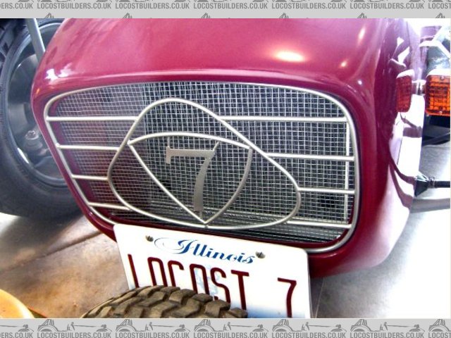

| posted on 8/5/13 at 07:21 PM |
I used plain 1/4" hardware cloth to protect the radiator and to allow for maximum airflow. This is behind a custom "7" grill formed
from galvanized brake line.
