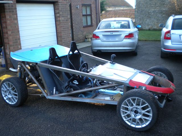

I am getting to the stage where I have to seriously consider the bodywork for my car! On my original idea, the upper side rails were covered full
length with a fibreglass moulding. I had thought of using 'Curon' pre-preg fibreglass for this as it gave a good finish without the need
for a buck/mould/panel three stage process.
It seems Curon is no longer available. I must confess, I find the idea of fibreglassing quite daunting - it would also be very messy = anti-social in
the domestic garage! A compromise I came up with a while ago was to use simple flat/single curvature panels at the rear and the modified Beetle
Bonnet (!) and the front - suitably fillered of course!
So, my question to the collective is this: Original Fibreglass plan - Expensive, time consuming, messy but best looking (if I get it right....) or
simple panels - compromise on looks but much easier to do!
Here are some pictures to help!:
Original Plan:
[img]
[/img]
Simple panels:
[img]
[/img]
[img]
[/img]
[img]
[/img]
