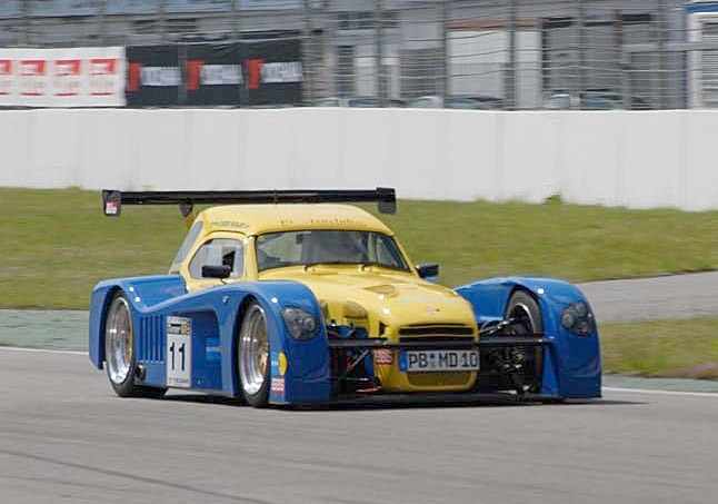

you mean donkervoort
the RS06 has the fully enclosed front arches you need, but needs a bit of work to make it look righ IMHO

| posted on 22/7/13 at 10:03 AM |
quote: Originally posted by mcerd1
quote: Originally posted by wylliezx9r
Take a look at the dankervoot for inspiration.
[img]http://thefactoryfiveforum.com/attachment.php?attachmentid=938&d=1299606538[/img]
love donkervorts generally, but that looks like the results of drunken fumble between an lmp1 and a seven.
(though i'm sure it goes well)
