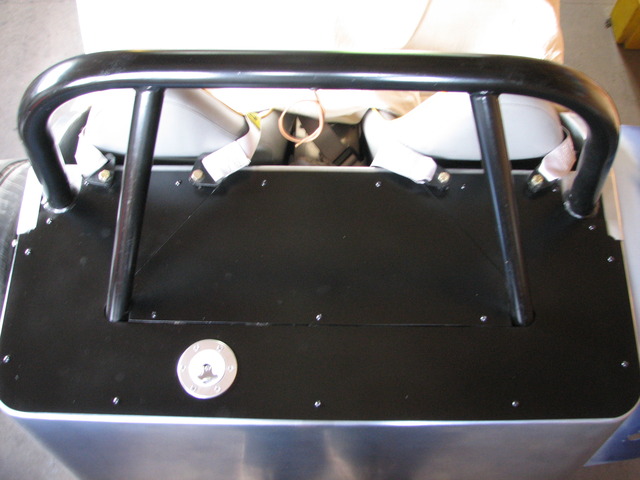

| posted on 27/10/13 at 07:23 PM |
  35l fuel tank over diff
Here is mine i just remove the lid to get to the filler easy
