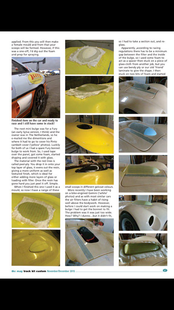

Just wondering can you get a styrker with a higher middle bonnet bulge,want to raise engine height to flat floor my race car ,Thanks in advance or any ideas what it would be like to cut a hole to allow engine up through then re fiberglass it

Google RGB images, plenty of modern bike engines are very tall so the racers have popped on various fibreglass bulges.
Just make it streamlined, it does not have to be symetrical.

Alternatively, get Andy at Westgate Composites (07733282947) to mod your existing one:
