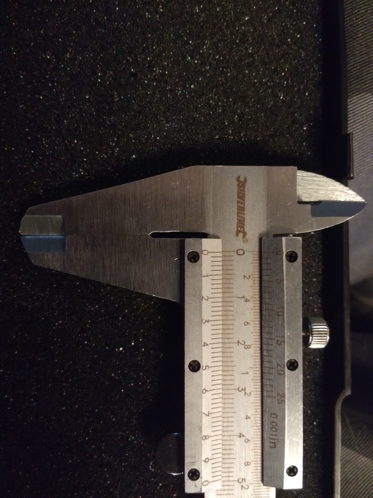

I bought a set of vernier calipers from Ebay, I thought I'd gone for cheap but serviceable. It doesn't seem like that though;
![](https://1.bp.blogspot.com/-fDCWoYQWMBM/WtZdGvi_h_I/AAAAAAAADHE/RB3bE6eYwxo86XCxLAAtkdiAqPgeqy5DwCLcBGAs/s1600/IMG_20180417_213931453.jpg)
Unless I've misunderstood how these work, when they're closed the two zero's should line up.
First off, is that expected? If so, is there a way I can manually calibrate them? I'm thinking some light application of a file perhaps? Or am I
asking for trouble?
I could just return them, but I do wonder whether I'm asking a bit much for a silverline tool?

Yeah, that's bad.
I'm wondering if the 3 crosshead screws hold the scales in position so adjustment is possible?

The heads are quite tight in the holes though, there's no movement available. But I like the idea, perhaps I could elongate the holes to make
them adjustable.

whilst that is on their minimum reading, the actual measuring edges do also have gaps, you can see light though the tips, and the internal measurement
jaws overlap.
try measuring a known size, and see what it says.

It’s not a mechanical fault, it’s a difference in the two printed scales
It’s out at 0 but catches up by 2 and then runs out the other way
Bearing in mind it’s supposed to be a precision tool imho it’s not fit for purpose

its a vernier scale, the offset gives more than 10 times the precision, when you know how to read it.

Doesn't look great to me.

Looking again at the photo I'd ask for a refund and send them back.

That looks about 0.2 when it should be 0. if youve got a known say 100mm parralel or something and its still 0.2 over then atleast you can use it
roughly! If the scales out tho its completely useless. I'd just buy a decent one,its something you'll use forever,and at some point
you'll make a cockup because of it!

I think I'll try and tweak them, I was after 0.1mm resolution so they should suffice if I can get the zero's to match. I'm not
measuring engine tolerances with it, but I do want better than the 0.5mm resolution that I can get from a rule.
