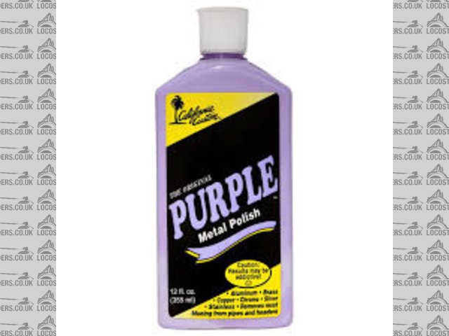

Another vote for Original Purple Metal Polish , quicker and easier than any others I've tried
| posted on 19/7/18 at 08:32 PM |
Where did you get that purple polish from? On-line, or over the counter?
The Meguiers stuff does work, but it can be a dirty process.

David, I got mine years ago from Stoneleigh but there is someone based in Yarmouth selling it on eBay , it's California Custom original purple
metal polish, about £22 a bottle plus P&P but it last ages . The first time I used it it initially didn't seem to be doing anything until I
wiped off the very small amount of black residue and saw the shine

I must admit it's not the easiest stuff to use, but being the sort of bloke I am I am willing to watch you practice on my car.
