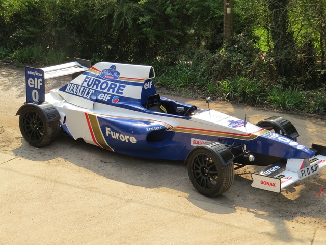

On something like the nose of a 7 you will need to split the vinyl & make an overlap. I had a Furore professionally wrapped last year & they
made joins in several places where the curves are too tight to allow the vinyl to stretch/shrink. If you keep the overlap to a uniform amount, say
about 5mm you won't see it from anything more than a very close inspection, unless of course it's patterned ort carbon effect!

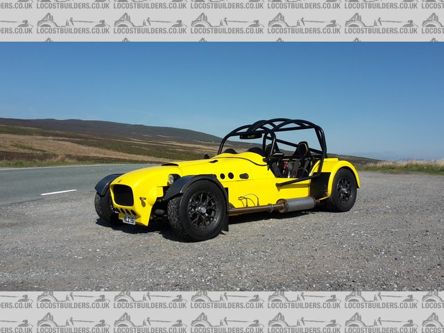

I have sprayed the nose cone, rear arches and one side pod with rattle cans.
Wrapped the scuttle, boot lid and one side pod with 3M 1080.
I prefer the sprayed finish, if you use quality paint (uPol in my case) prepare well, 1 coat etch primer, 3 top coats and 2 coats of clear,
you can achieve a very good finish. The wrap is OK, but the gloss finishes aren't really gloss.
You can pop over and see for yourself if you want?
Wrapped pod
Rattle can sprayed nose cone
Rear arches

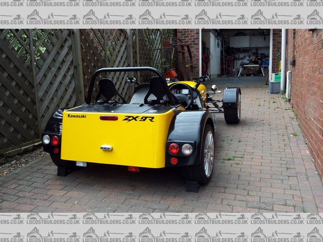

Check out my project thread, or my pic archive. Wrapped mine myself for around £100 using KPMF vinyl
Only hard bit is the nosecone which I split into 3 or 4 pieces

russbost
| posted on 3/10/18 at 07:07 AM |
This had joins in a no. of places, you certainly wouldn't ever see them unless you were specifically looking for them - important to keep an
even edge, say around 5mm overlap
