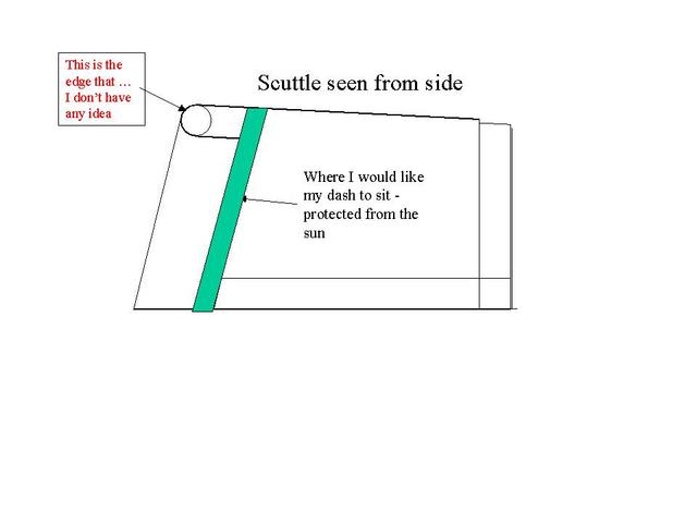

kango
| posted on 1/2/05 at 04:32 AM |
I need my dash panel to sit about 50 mm deep in the scuttle, so the dash can not finish the edge of the scuttle off.
MikeP
| posted on 1/2/05 at 02:35 PM |
An edge like that is very do-able, but tricky. You might end up wasting a bit of ali till you get what you want. If you can, try doing it in 22g
instead, then you can attach it with spot welds and finish it with hammer and bondo - a nice finish in bare ali will be pretty tricky.
To bend around the tube, you need to clamp it as tightly as possible on the top edge, then gently encourage it around with a soft (plastic) hammer.
Hammer from the start of the curve (top) and smooth it down, it'll stay tight against the tube. You'll need to anneal it a few times to
kee it soft, and you'll probably have to end at the bottom of the tube - that straight section to the dash will be tough.
It'll wrinkle in a fashion similar to tucks, you need to hammer them out to shrink the ali - check one of the metal shapers sites for
"tucking" to get the technique.
Another idea, like Pete mentioned, is a wired edge, like u can see here:
http://www.7builder.com/Gallery/Bodywork/html/AliFrontQuarterRolledEdge.html
Again, the metal shaping forums are a good place to start for tips. If you do this, you need to figure out a different way to hold the skin on - glue
it to a steel skin like Mark, or provide a gluing or riveting surface on the top of the tube at the front and rear hoops.
I'm sure the rest of the guys will have some better ideas, hopefully these'll get you started thinking. Good luck!
Mark Allanson
| posted on 1/2/05 at 07:48 PM |
If you make a tubular rear support for the scuttle, this ahould be quite easy. Fix the ally to the front hoop using you prefered method with a good
overlap over the rear, 2" looks fine. Use a rubber mallet, and form around the rear hoop. This is not a time to get in touch with your feminine
side - use as few mallet strokes as possible AKA beat the living daylights out of it! You want to get the ally arounfd the hoop before it realises
that folding is easier than stretching around the round tube.
