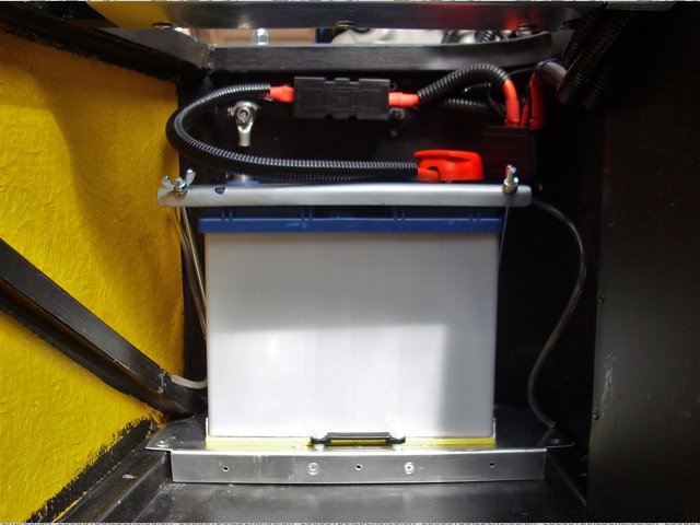

I fitted mine in the footwell, passed IVA.
The battery may need to be isolated from the passenger compartment?
This is mine:
![](/galpreviews/bat5.JPG) ![Description](/gallery/bat5.JPG) Description
![](/galpreviews/2bat3.JPG) ![Description](/gallery/2bat3.JPG) Description
![](/galpreviews/bat6.JPG) ![Description](/gallery/bat6.JPG) Description
![](/galpreviews/bat4.JPG) ![Description](/gallery/bat4.JPG) Description
[Edited on 3-3-21 by 40inches]
[Edited on 4-3-21 by 40inches]

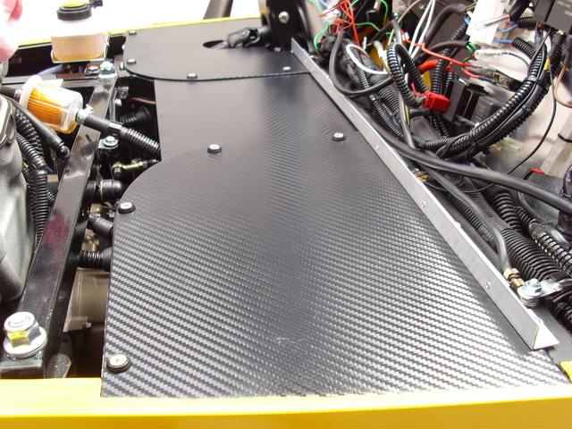

spot the battery
![](/galpreviews/2016-02-27 20.46.53.jpg) ![New passenger footrest](/gallery/2016-02-27 20.46.53.jpg) New passenger footrest
Howard

I did exactly the same thing as HowardB, put the battery in the passenger footwell and covered it with an ali panel fixed to the floor with bolts and
wingnuts. Passed IVA with flying colours. The panel is necessary to avoid the IVA sphere of doom, without which you will probably fail the
inspection.

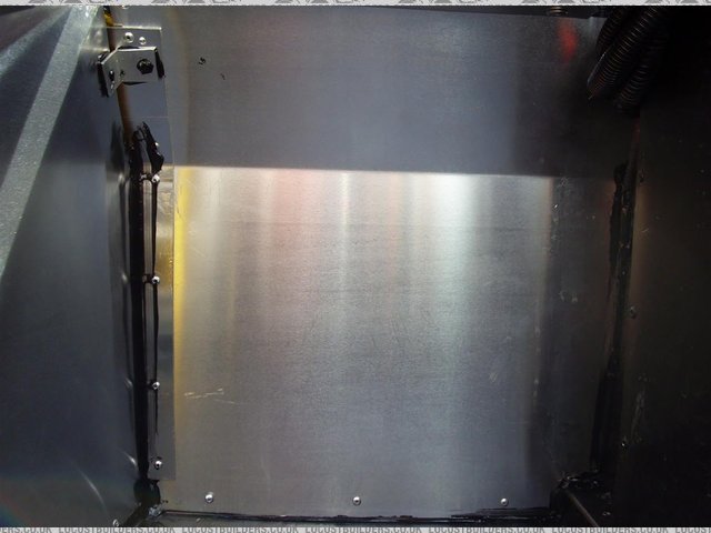

That is why mine is behind a completely sealed panel
There is still enough leg room, the same as the drivers side.

That's exactly what I have done, effectively moved the bulkhead back and sealed it, both the original bulkhead and the new one are 1.5mm ally,
the battery vents into the engine bay, as does the battery compartment.
The battery is behind this panel, sealed all round.
