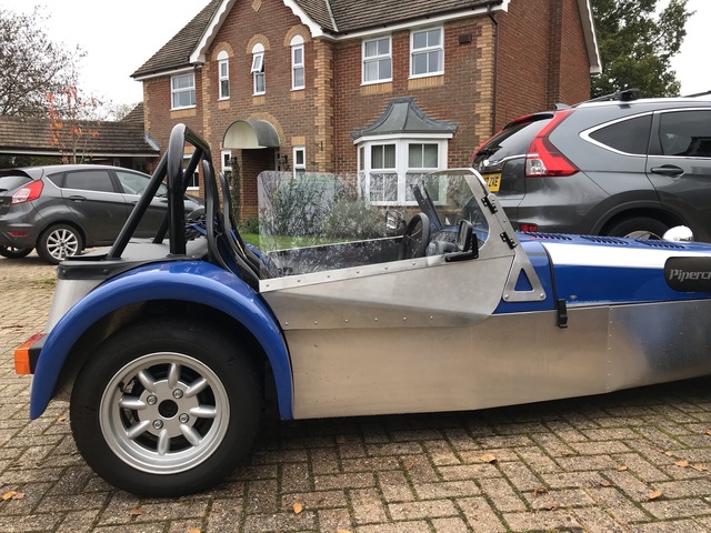

| posted on 18/6/23 at 05:00 PM |
Hi Gary, thanks for posting the photos. Those doors are really cool and a bit different from the usual style. Giving me plenty inspiration and
ideas.
What thickness is the aluminium and Perspex? Does it stay quite rigid at speed?
quote: Originally posted by GaryM
  Locost Door
  Door Inside before trimming
  locost roof
They look a bit strange but plenty of elbow room and the rear arches take some of the weight off the hinges. Also this coincided with the line that
the roof would take from the screen to the roll over bar.
Gary
[Edited on 18/6/23 by GaryM]
GaryM
| posted on 18/6/23 at 05:13 PM |
3mm perspex and whatever 'The Book' recommended for the bodywork (I had some left over), maybe 1.2mm?
Yes perfectly rigid. I did notice from Caterham videos that some of their doors tend to flap at speed so I went for a design that was more rigid, easy
to make and maximum side visibility. The intention was to only use them when I thought it might rain but they totally transform the driving experience
to the extent they stay on all the time!
