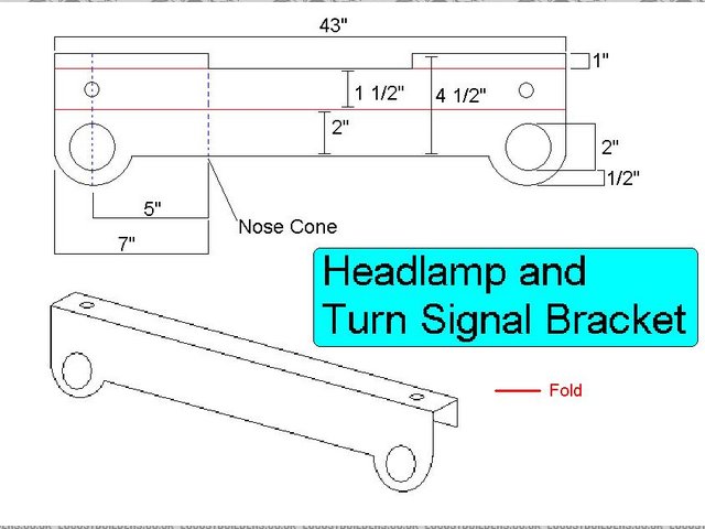

derf
| posted on 17/11/05 at 01:54 PM |
My solution:
  Headlamp and turn signal bracket
