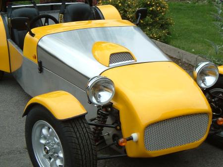

David Jenkins
posted on 30/5/06 at 07:14 AM Reply With Quote
Do you mean like this?
I got that from Redline Components, who sell spares for old Caterhams. The scoop was made out of grotty grey GRP and needed some work to bring it up to a good finish. Not stupidly expensive, I recall.
cheers,
David
Humbug
posted on 30/5/06 at 07:57 AM Reply With Quote
cheers,
David
David - that might work. When you have a moment could you measure it? The hole in my bonnet is 17cm x 39cm - not sure from your pic whether the curving sides of the scoop would actually cover the hole.
[Edited on 30.05.2006 by Humbug]
David Jenkins
posted on 30/5/06 at 08:00 AM Reply With Quote
Does this help?
LINKY
DJ
joneh
posted on 30/5/06 at 08:25 AM Reply With Quote
Aye! That looks much neater than a dirty great vent!
