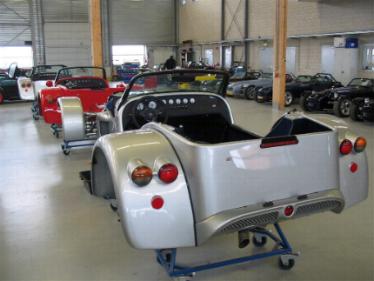

jack trolley
| posted on 6/6/06 at 06:01 PM |
These?
tks
| posted on 6/6/06 at 06:07 PM |
YES!
They are from the fiat Coupe
mhhh hellfire dunno your trick could you explain?
I want to make them like the donkervoort
(its that grey car james talks about)

| posted on 6/6/06 at 06:24 PM |
And you want them like this?
tks
| posted on 6/6/06 at 06:27 PM |
Yups
Offcourse not completely the same maybe they have pattent
sow its just a how do i copy that radius to this tube problem..
Tks
The above comments are always meant to be from the above persons perspective.
