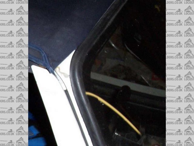

I've now fitted my windscreen in my middy but there is an untidy edge / gap where the glass meets the grp recess. I could fill this gap with PU
adhesive but I would like to find a more elegant solution.
Is there some kind of moulding strip that would go round the unfinished edge to tidy it up?

That sounds more like it! have you got any dimensions or pics Adrian? I assume you used a new one from a Ford dealer?
Raz

Windscrren man had it in his van, i've attatched a crappy pic i had on pc, let me no if you want a better one
Adrian

MkIndy7
| posted on 10/7/06 at 10:19 PM |
Ahh, think i've seen another donor for that rubber.
It looks like the ones used on Fiesta's when they have airbags. (Mk3.5 at least)
The screen is bonded in and then that trim covers the gap.
They might all be like that but presume it would be a conventional rubber on non Airbag cars.

Ah, it might be worth having a word with a screen replacement company then. I can't quite make out the complete shape so a better pic would help
a lot. Also a cross section of the shape would be great if possible.
Raz
