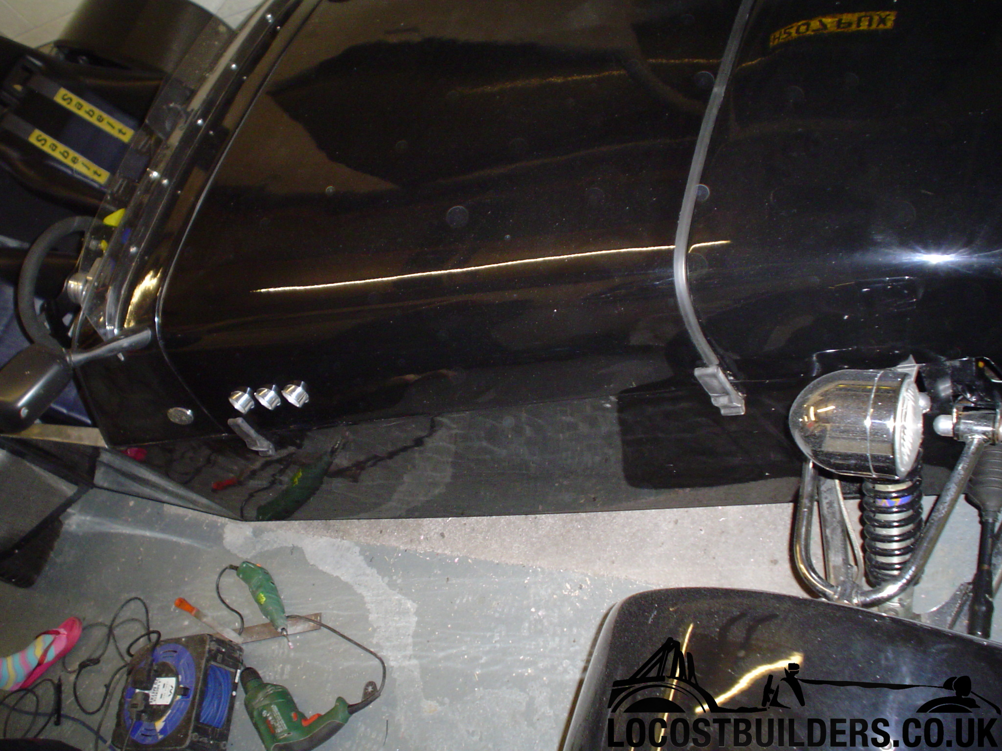

I have drilled 3 holes where u have but only on the sides (for now) using a cone cutter (very smooth for cutting this stuff). Then i had a bright
idea, not sure if its too tacky but its undoable if it looks odd. i am in the process of welding 3 small alloy tubes to a plate that will stick out of
the holes angled backwards. sort of looks like an exhaust off a spitfire. I did this to b different AND to help the air eascape sue to the angle
creating a vacume around the vent. i was unsure from the shape of the bonnet if cold air would enter or hot air would exit, i dont know the airflow at
that point.
will post a pic later this week if i have them done.

Moorron
| posted on 2/8/06 at 09:16 PM |
hers my latest work, i just hope it doesnt whisle when drivin lol
Sorry about my spelling, im an engineer and only work in numbers.
Moorron
| posted on 2/8/06 at 09:17 PM |
erm.. how do i get it to work??
