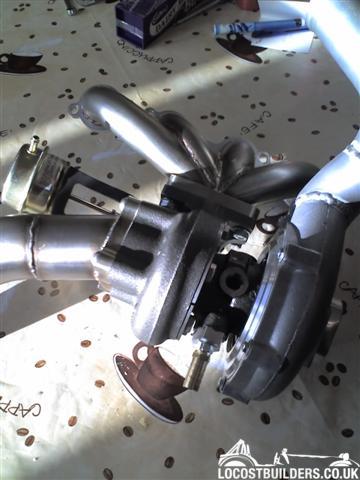

the turbo is a modified mitsubishi one, when you talk of water cooled do you meen water injection?? in that case no, niether is the turbo, I think im
running 12-14psiboost, Idid have it running 26psi boost through the e-boost controll but it was undrivable below 80mph, even at 80 mph you had to
leave it in top and hold on, im running a 3.14 non lsd, this helps the driving, I tried all different diffs other than a quaiffe, the back end will
still kick out but you get more of a warning.

| posted on 30/12/06 at 11:52 PM |
Was referring to the turbo itself Andrew, being water cooled,just could not see on your pictures how you had routed your water pipes,yours must be the
type that rely oil for both cooling and lubrication,a lot of the garret turbo's are water cooled.
