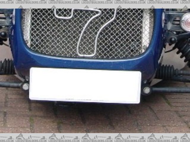

Depending on the effect you are looking for and your confidence with making the bulge, you could avoid the bulge by raising the nose cone like I did:
pieces of 30mm x 30mm x3mm ali U channel at the sides and under the bottom of the nose

If you raise the nose cone as humbug suggests surely you will expose the bottom tubes. Is this acceptable for the SVA or will it then fail on radii
You're right - the bottom rail is exposed and you can see the bottom front wishbone bolts. I did this after SVA, so not a problem, but I have now
put nut covers on the bolt heads, and I don't think the bottom rail would be reachable by the SVA man's cone as the cone is too
upright.

Bob C
| posted on 3/1/07 at 10:58 PM |
SVA have a 30degree from vertical cone to say what's "under the car" & can be made out of razor blades - bottom tubes are
probably exempt.
