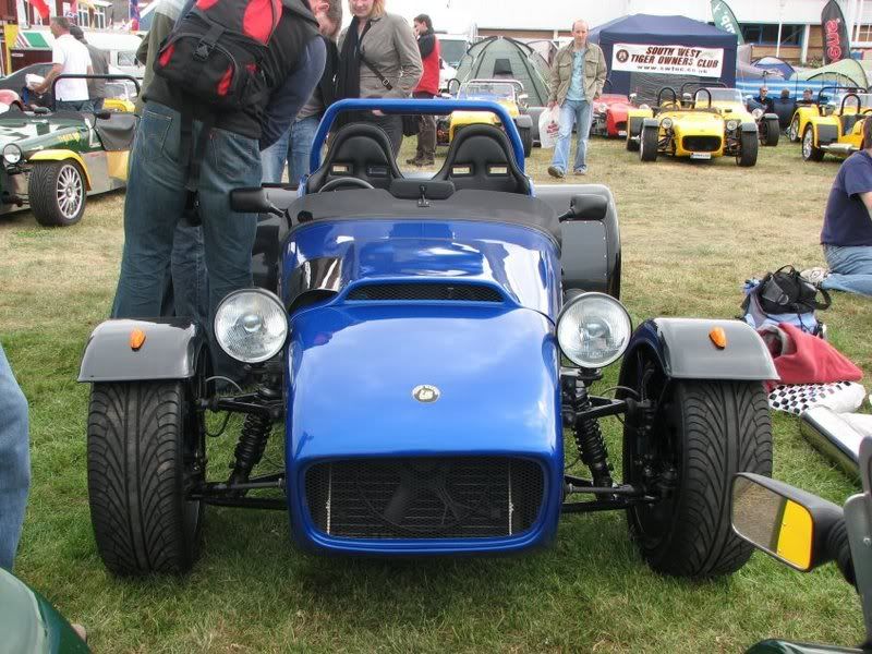

Is this the one?
http://www.tigersportscars.nl/
images/Avon_neus_02.jpg
What about engine cooling? It does get hot here.
Do vents cause any unwanted bonnet flutter or extra noise? I guess I'm asking is there a disadvantage?

soggy 3
posted on 11/7/07 at 05:43 PM Reply With Quote
Early avon bonnets like mine had a vent at the front, it doesnt flap about a bit.

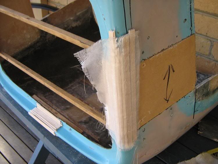

More pictures soon.
It looks like the motor might stick proud.
Dave D.
BTW this is the first time I have done this and happy with the results. Many years of model aeroplanes helps. This is a buck to make a mold as well so don't worry about the strength.

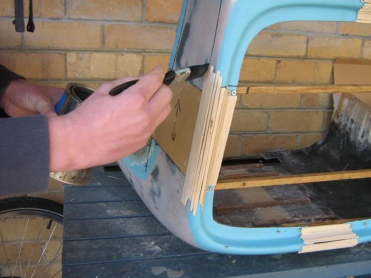

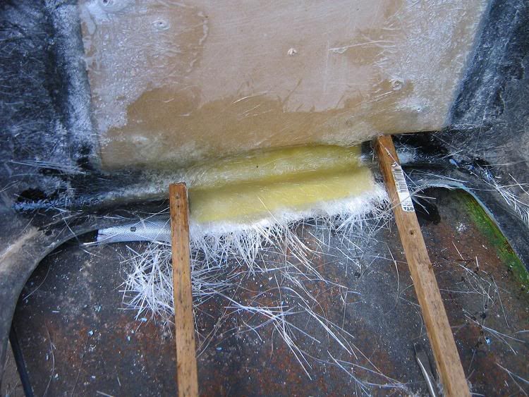

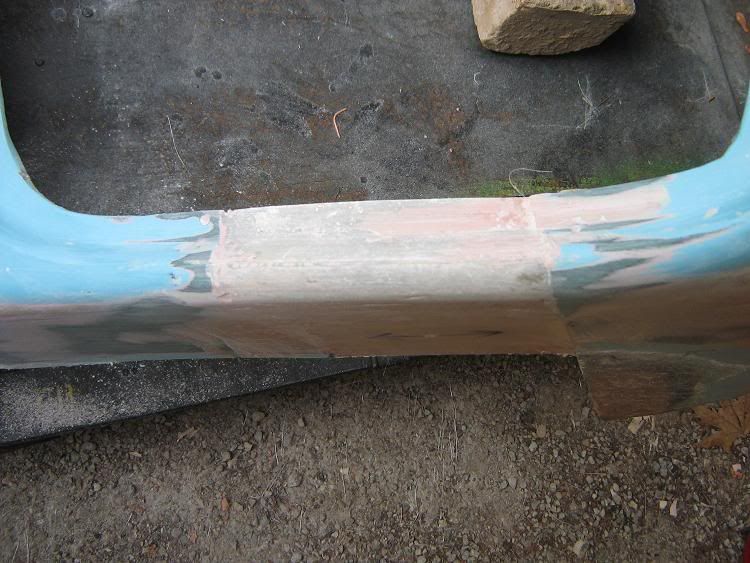

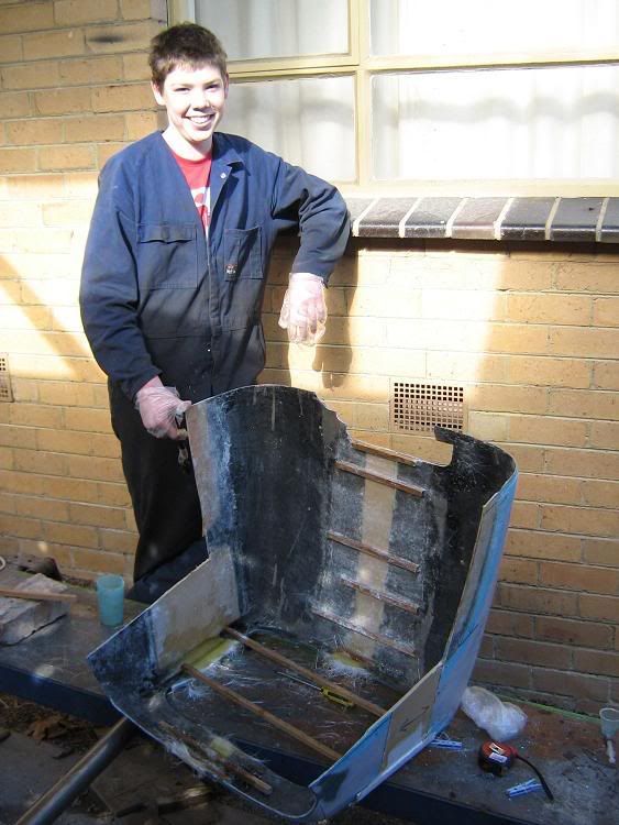

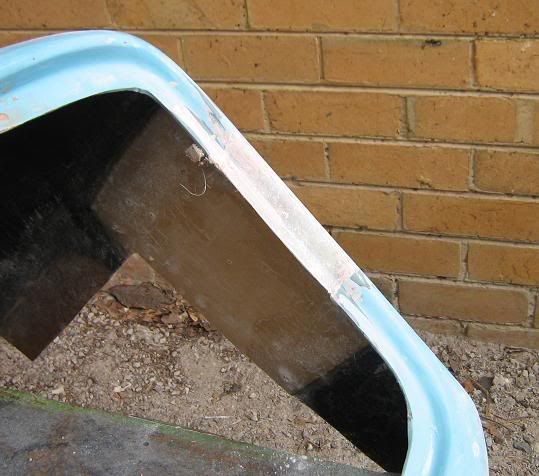

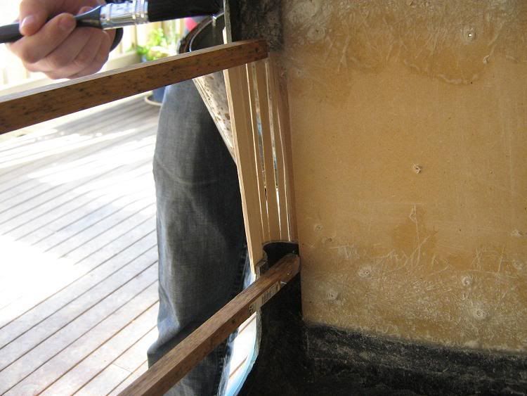

dave_vic_ozz
posted on 13/7/07 at 05:33 AM Reply With Quote
Ed has been busy over the school holidays and here is his handy work.
What you don't see is the packing tape stuck onto the inside of the former so it would peal off after the former was removed.
In the bottom photo you can see where I had to cut the new section from top to bottom to push it back into the correct shape as the balsa former dislodged. I have put a light coat of car bog to fill the little air holes (and some bigger ones too.)
